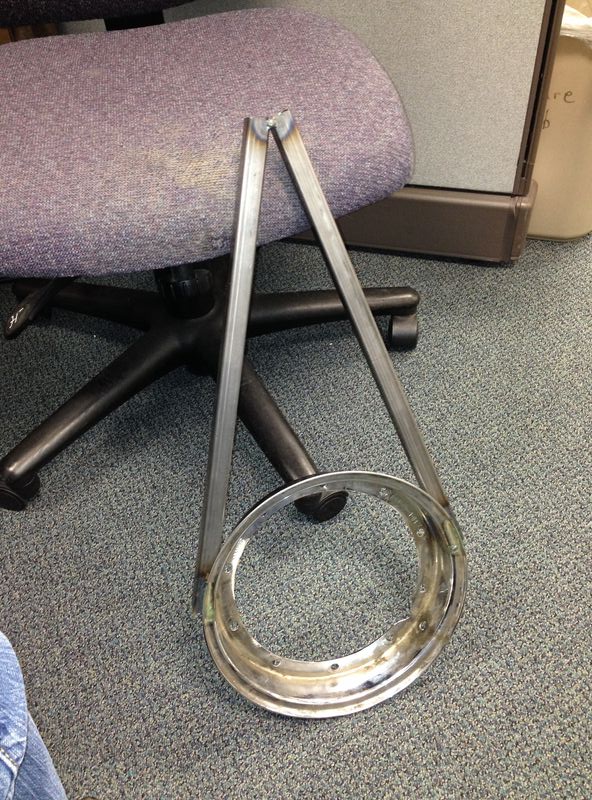

Beats my " get behind the scooter in the doggy hump position and stretch right leg up around to brake pedal while reaching with left hand to pull or push a breaker bar or torque wrench" method
Yeah, I have short legs and arms. I did it missionary style last time but it's hard to read the torque wrench from above .
It was a bent rim with no future, now it's a tool!

That's cool! I'd like a hib holding tool!!

1) rear hub nut installed using my schnazzy new tool, torqued to 60 ft-lbs and then turned until I could get the cotter pin through
