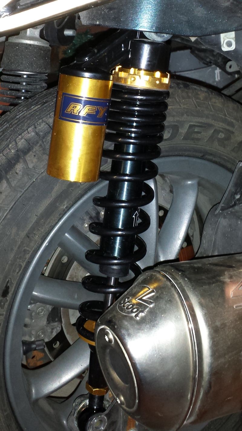

Just a quick teaser. Unfortunately, it appears that Illinois has been annexed by Minnesota. While it's kind of humorous to see people cutting what looks like mountain passes for the sidewalks into the mounds of snow piled on every street corner, it doesn't make for a conducive environment for working on my bike or riding

Just a little more info. Here's the link to where I got them on eBay:
http://www.ebay.com/itm/291031619717
Looks like they're on sale right now, too, so you can get them for under $100.
The eyes are narrower than the stock shocks, so you'll need some sort of way to fill the space. I went to Farm & Fleet and got a handful of 3/8" washers that fit practically perfectly over the stock bolt. (I know, I'm mixing SAE and Metric, but there's not a whole lot of choice from metrically-challenged American hardware stores...)

heinlein wrote:
I hope you have another one too.
I do, but I only had 1/2 hour between when I got home from work and when I had to go to band practice, so that's all I got done. And I don't think the temp has climbed out of the single digits since then, so it's been too cold to work in a garage that's not heated or insulated...
Also, I had to make trip 1 to the hardware store to get the aforementioned washers.
I'm kind of glad I didn't put it all together then, anyway, because as OAD and I looked at the pic, we think I might be able to turn the shock around, so it can still be slid up out of the way when changing tires instead of having to be removed every time. We'll see...

this shock is a great alternative for those who also want to lower their scoot some as you can get them in a shorter length as well.

Nice find!!! Thanks for sharing the link where to buy it as well!!
Now, is it my glasses or your tire has passed by thousands of miles the replacement time?!!?!??! Holly...Hope your not driving in wet conditions!
I have maybe 20 miles on that tire. But it's a darkside (car) tire, so that's why it looks different.

Is there a secific advantage to using these? Or are they just a replacement for worn OEM shocks?
There's a couple of advantages. The air pressure in the shock is adjustable, so you can control the rebound rate. The spring adjustors are threaded, so they're continuously adjustable instead of having 4 pre-defined stops.
I've only about about 20 miles on the new shocks, so I really can't give a good review yet. Hopefully soon...
They certainly don't work worse than stock so far, for what that's worth...

Last weekend, I put about 360 miles on the scoot. So, after an extended time on the bike, what are my impressions on the new shocks?
Well, pretty much the same as before. I'm still not sure what I think about them. At the very least they're no worse than stock. But are they an improvement? I'm just not sure...
It's entirely possible that they just need to be adjusted more. That could be pre-load or air pressure, but I'm out of my area of expertise there...
I think what we really need is someone who has used other replacement shocks (Hagon, Bitubo) to compare and contrast them.

They just arrived today. Probably won't have time until next week to install them. Besides, I still need to shop for some washers and use them as spacers like what CubsKing did.
By the way, just so you know, you can probably order the 14" ones and they can add about 10mm in length from the adjustment on the bottom if so desire. Only drawback with the 14", according to the seller's description of the item was that the max loads were 450lbs per pair, instead of the 650 that I ordered.
These shocks don't really have instructions included, so I will have to figure which way to turn to adjust the spring tension from the top. It says something about a 20mm length adjustment from there.

If you can find (or make) real spacers, that'd be better than having a stack of washers. (Or, as I did it, two stacks, one on each side of the eye.) It's really hard to get the widths right and then line it up and put a bolt through a stack of washers, an eye, and then another stack of washers...
Basically it's going to be something like these, using 3 (approx 6mm altogether) of them glued together and place them on the inner side of the eyes, I think.
http://www.amazon.com/Steel-Washer-Plated-Finish-Metric/dp/B009OK50UM/ref=sr_1_1?ie=UTF8&qid=1400304653&sr=8-1&keywords=m10+washers
If possible, I'd like to find something in that size but made out of rubber. I found some but they're in UK. Oh well, I'm sure someone carries them in the U.S.

Another update:
OAD took a look these on my bike at AmeriVespa. We're pretty sure that the springs on the 16" (400mm) springs are WAY over-sprung. The springs are rated for 650 pounds. When you push down on it, they barely move.
The shocks he has (or had) on his Cannonball bike were 340mm and used a thinner spring. I believe it's 7mm thick and supports about 450 pounds, but I don't know for sure. Hopefully, he'll take a caliper and measure them for us (hint, hint...)

And I will post a little update on my project... have been busy so I didn't even have time to finish it.
Went to Ace Hardware and got some rubber washers (12mm inside diameter) and stainless steel washers (30mm OD, 10mm) for the spacers.
Since there is a 10mm gap that needs to be filled, I have decided to use one stainless steel washer and one rubber washer on each side of the eyes. The rubber washers would all be trimmed to 30mm on the outside diameter (which I have already done but they didn't look like perfect circles ).

CubsKing99 wrote:
Another update:
Mark
Maybe I should have ordered the 340mm then?

Yep, it's severely over-sprung. I just did a few measurements and the results shocked me.
Now, before I give the numbers, I will warn you they're probably not exact. I was working by myself and using a measuring tape for sewing, so I don't think I got my numbers dead center of the eyes every time. But they're good enough to go by.
Up on the center stand, my shocks measure 405 mm.
Off the center stand, resting on the rear wheel, it measures 403 or 404 mm.
Yes, you read that right. The weight of the bike only causes it to sag 1-2 mm. With 68mm of travel, that's about 1.5% to 3% sag.
I put my helmet in the top box, laid a new 50 LB bag of salt sitting in my garage on top of the box, and draped my jacket over that. Then I laid across the passenger seat so I could reach down and measure the length. I'm about 200 LBs.
With that weight, as far back on the bike as I could get it, my shock length was about 395 mm. That works out to 14.7% sag.
In general, it's recommended that there should be about 30% sag in the shocks. I'm seeing less than half of that.
After I got my numbers, I noticed/remembered that I'd adjusted the adjustment ring of the shocks right after I'd first put them on while trying to find the sweet spot. It didn't seem to have made any difference, so I had left them alone. For the sake of completeness, I just went out, took them all the way to the top (took all the pre-load out) and did my measurements again. They were almost exactly the same, but about 3 mm longer. 408, 406, 398.
I don't have a comparison to the stock shocks. If someone still has stock shocks on and could do the same testing, I'd appreciate it. I've still got my stock shocks, so I may try it if I have time. But it'd be a lot easier for someone who didn't have to remount shocks, and it only takes a couple minutes...
Oh, something else of note. I busted out my digital caliper for the first time and took measurements of the thickness of the springs. The spring thickness on the 400 mm RFY shocks is between 8.4 and 8.5 mm. On the stock shocks, it's between 6.5 and 6.6 mm.

cubs those numbers would be what I expected after seeing them and feeling how stiff they were at NOLA.

Yeah. Like I said, my numbers may not be exact, but they're in the right ballpark. And they definitely show those shocks aren't optimal, at least without some modifications.
I talked to LM15 on the phone today. He just got a set of the sames 16" ones as I did in yesterday. He's got a place nearby that does a lot of sales and work on racing bikes as well as shock rebuilds. He's going to take them over and see what they can do to make them better.

OK, so I measured the stock shocks. It measured 410 on the center stand and 380 loaded down.
