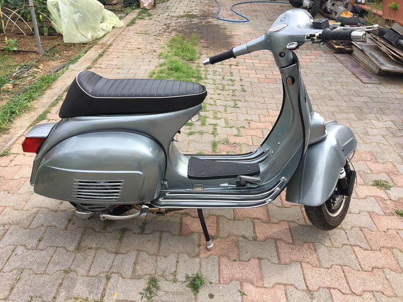

Hi all. A friend brought me his beautiful Sprint Veloce. It's been blowing up bulbs for a long time now and he doesn't know what else to do. The only thing he knows is that the guy that restored it, had changed the coils. So far I have taken off the tail light and discovered it had a 12V-21W for the rear light and a 12V-10W for the brake light. Probably to avoid blowing them up, but they blew up anyways. The 12V-21W also burnt the bulb holder so I'll have to come up with something to repair the tail light. I wanted to measure the coils output but can't seem to find any info on resistance and max voltage when they're disconnected. It's a EU spec 6V Sprint without a battery or rectifier...

Update time. Lots of problems in the harness. It was supposedly a brand new Italian repro harness. Anyways, I fed a new ground wire everywhere, replaced the broken brake light switch, gathered the ground wires under the tank where they'll be connected to a central key switch (for safety / anti-theft purposes) which will be mounted beside the choke lever. I used new terminals everywhere and wire ferrules at the light switch. I've also repaired the tail light (burned by the 21V-21W bulb) and tomorrow will start the engine to see what I've achieved so far. Fingers crossed, no more blowing of bulbs.
Few photos. Last one is for Terry cause he loves COSAs (this one has another story)...

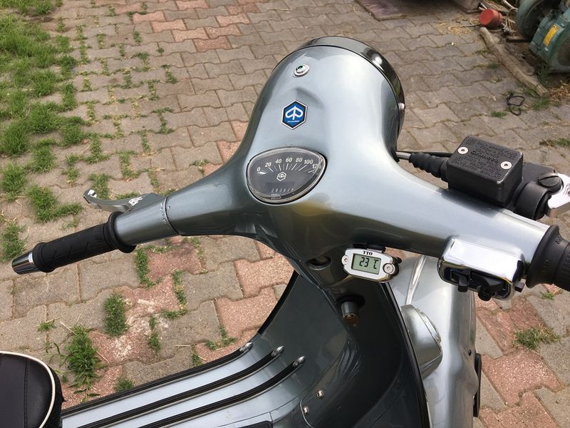

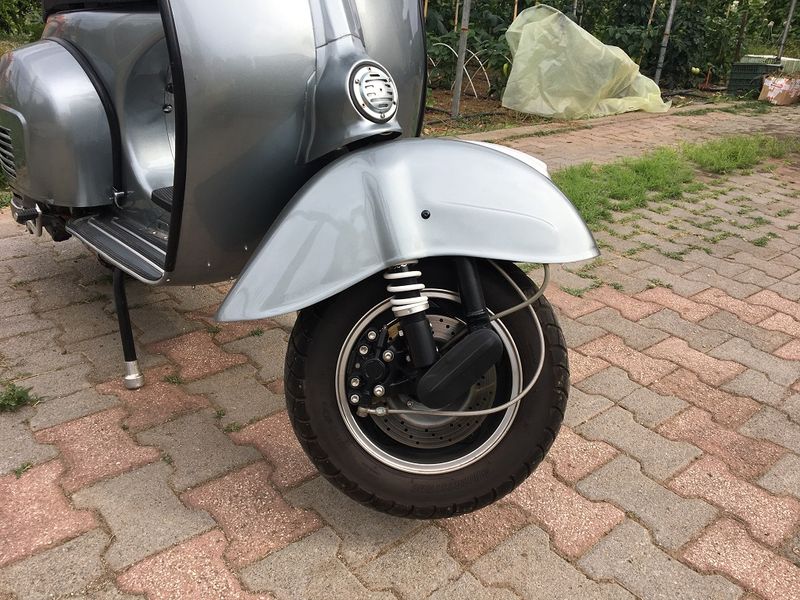

Thanks. Lemme see the handlebar on the other side. There's gotta be a master cylinder there somewhere. Cosa looks to be in fine (original?) condition and same color as mine was. That front brake isn't original though.

About the brake on the Cosa. It has a PK Brake Lever with a manual choke (e-choke was ditched) and uses a typhoon brake master cylinder inside the horncover. So it's a 50-50 disc brake system. The scooter's not original. It was restored last year by a friend, for another friend, but the engine seized after 500Kms. The friend that built it, doesn't want to work with it (although he's responsible), so I must be the detective on this one. Anyways, it's next after the Sprint is finished...
