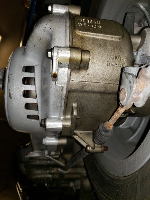

I just noticed some oil around the back tired and a little bit on top of the bottom part of the suspension. I cleaned it a bit and I noticed the oil is fresh and clear (I guess clean), but I do not know where is coming from. I checked the engine oil level and it is between the Min and Max. I am concern since it looks like a lot of oil. I need help, I am attaching a few pics.
It is a 2008 Vespa LX with just over 600 miles. I started using it a lot lately.
Thanks!
From underneath

Check the oil level to see if it's overfilled.

It looks like the oil has been overfilled in the past and is collecting in the air filter box. Look for gobs of oil in the air filter. If the filter is clean, another possibility is that the shock absorber is leaking oil. Bounce the scooter up and down and listen for clunking sounds, and see if the rear of the scooter continues to bounce more than once.

An oil filter full of oil could be part of the starting problem. Clean it up first and see if that helps.

There should be a small transparent "tit" thing attached to the bottom rear of the airbox. Run your finger along the bottom of the airbox. Oil will not travel forwards.
I'd say from the shock.

No, do one thing at a time. Check the air filter and clean that up first. The oil should be changed eventually -- it looks old and dirty -- and you'll change the oil filter then (if there is one on an LX50).
Waspmike also suggests the shock. If you rule out the air filter as the source of the oil, look at the shock again.

UPDATE!: I called Vespa and last and only record they have about my vespa was a Basic Maintenance and both tires were changed. This happened about 1 year ago. So, I guess oil needs to be changed and the shock is the problem causing the leak, now, they main question is: Should I let them do it? or should I do it myself? I reviewed how to do it and it does not look complicated. What do you recommend me to do?
Joined: 06 Jun 2013
Posts: 2698
Fri Jan 11, 2019 11:29 am quote
Hold on! Did you look at the air filter yet to see if there's oil in there? The oil may not be coming from the shock. It's rare that shocks fail at only 600 miles.
Check the air cleaner first, and clean up all the oil.

Looking at the spring itself. Itís rusty and dirty brown until the last 3 bottom coils which are black and covered in oil.
Thereís also a gap between the air box and where the staining starts on the transmission cover.
My first thought would be the shock is shot...... but as above no time at all to check the air filter.
Back to the shock.
Itís very easy to change. Remove the battery cover and the battery.
Undo the top nut of the shock.
Then undo the bottom nut and bolt.
Remove and replace the shock. Took me about 15 mins.

Yes, I checked the air filter and it is not that bad. I went to Vespa and they just knew it was the shock when they looked at it. they bounced the bike and they showed me. They also said that based on the oil (dark oil by the wheel) it started happening a little while ago, and I just noticed. They said it needs to be changed, but nothing urgent. I am just going to feel the jumping up and down. He recommends to change it soon. I was quoted $190 including labor.

It looks similar to the oil leak on my P200e which turned out to be the shock absorber. I replaced both front and rear. Problem solved.
