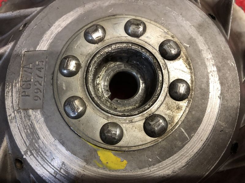

And this one's pulled from a working spare P200 motor I have around...

SaFiS wrote:
This one is a points ignition flywheel that's why is different...
no it literally says electronic on the flywheel on the pic above plus....
'01 ET4; '65 VBB Restomod with P200E engine, '67 VW Type 1, '80 Airstream
Joined: 05 Jun 2018
Posts: 289
Location: Cary, North Carolina
Sat Apr 06, 2019 10:34 am quote
Also it cant be for points ignition, there is no lobe on the hub to open and close the points.

Your problems sound like a nightmare. If this is the wrong flywheel what is it supposed to fit?
How many degrees out is the timing? Did you measure with a strobe light? Is an option to forget the marks and move the stator to where the timing is correct (23 degrees).
Then you can move onto the 'what else is wrong in this motor' stage.

Can you post a picture of the stator and a close-up of the crankshaft?
At this point, I'm thoroughly confused by what looks like a points flywheel, but a Ducati CDI.
I'd like to have a full inventory of relevant parts so we can figure this mystery out.

New flywheel keys showed up today. Dug out my old pointer torque wrench that was a gift to me from my father's childhood best friend. He gave it to me when I was 17 in 1988 and I dont recall ever using it on anything but the heads on my first 1967 VW Beetle (my first car)
Spec says 47 ft.lbs on the flywheel nut on this PX200E motor. it was damn scary putting it on that tight but hey....WW2 was won with a torque wrench, they didnt just say 'oh that's tight enough' so i spun it on around.
Yeah she fired up on the first kick. 23 degrees lined up nearly perfect with the strobe, couldn't get a pic of it though.
Leaking out from the exhaust flange is the only issue but I was told that would probably happen. Rode it about 1 mile and wew lad the power.
Thanks to everyone who helped and a word of advice to any noobs like me, when you buy a rebuilt motor no matter who it comes from, verify the torque on the flywheel nut BEFORE you crank it.
