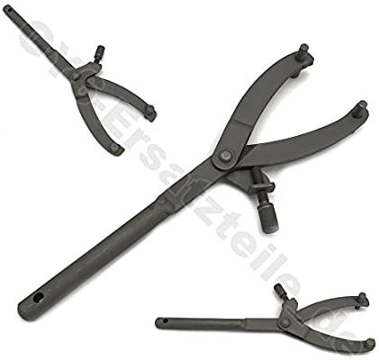

Does anyone use the one on eBay/Amazon/AliExpress or is it junk?

Many sellers all selling what looks like the same Chinese one.

Or for more $ this Bikemaster / Tucker Rocky tool
https://www.steadygarage.com/store/bikemaster-variator-clutch-tool-get-gy6-zuma-125
https://bikemaster.com/pin-style-flywheel-holder.html?___SID=U
And of course there is a $$$ factory tool

I have this tool and do use it. It is not perfect, but OK both for 50cc, 250cc and 400/500cc.

That top tool?
It's $9 shipped on eBay so for that $ it's a no brainier.
What are the short comings with it? Is it strong enough for ocassional use? It will probably on get used every few years.

My concern is are those pins strong enough for a retorque or will they bend like cheese. Some Chinese tools are strong and others are cheese metal.
No doubt that Bikemaster tool is made in China too.

The pins won't bend but the arms may. My homemade variator holder is made of 1" x 1/4" steel bar stock. My first version used thinner bars and it did twist and bend. YMMV.

So from this thread are links to that same tool above, a copy of a Honda tool maybe as stated?
It's the exact same tool sold everywhere.
https://www.amazon.com/YunShuo-Variator-Remover-Puller-Scooter/dp/B071FG7BR2/ref=sr_1_9?ie=UTF8&qid=1506200031&sr=8-9&keywords=variator+tool
Also in thread is the home made variator tool using 1/4" pins
That is said to work.
1/4" = 6.35mm
Chinese tool has 7mm pins (look at link above).
Dam close even if you need to grind down that Chinese tool pin ever so slightly.
So how does this Chinese tool not work almost the same home made tool does JimC?
What size are the pin holes on the variator?
And how far apart?
Am I missing something here?

Confused why not? Care to elaborate vs just say buy the $100 tool that I may once every 4-5 years.
Pins the wrong size?
Pins too short?
Arms don't spread wide enough to fit the variator?
Tool is in the way to retorque the nut?
Did you actually try on a BV?
My MP3 uses a different way of holding, bolt on a Buzzetti tool, but it sure looks like the BV uses pin holes.
As for the clutch that just needs two screwdrivers / bolts / rods etc that fit in there well and that locks up and is ready to accept torque to the nut.
Thanks!

More pics. Same damn tool sold all over the place at various price points. Reviews are it strong enough Chinese pot metal.

Pin sizes. No mention of length but it possible to approximate.

Any else care to explain why that tool's small pin will not fit in those 2 holes and hold that part well enough to torque a bolt on it?
Even if I need to grind them ever so smaller to fit.

My apologies - that is the first Piaggio variator I've ever seen that can take the pins on that tool.

Even though I haven't measured the hole, 1/4"pin is fairly tight. I'd bet cash money you'll be grinding the tool(or you could drill the hole).
My home made tool has been used on all my bikes close to 20 times. Seems to me that this is a lot of effort put in on something so simple.
1/4" = 6.35mm
7mm = 0.275
My homemade tool uses 1/4" bolts. They fit perfectly. Note -- the unthreaded part of the bolt is used for the pin. Saw the hex head off a 3" to 4" bolt, use two nuts on the threaded end to hold it to the "arm", one nut on each side.

Tue Jan 14, 2020 5:31 pm quote
JKJ-FZ6 wrote:
breaknwind wrote:
1/4" = 6.35mm
7mm = 0.275

Wed Jan 15, 2020 7:45 am quote
breaknwind wrote:
1/4" = 6.35mm
7mm = 0.275
Not alot of effort, just verifying that I'm looking at this the right way with holes in that part and a pin tool needed. Doing my homework before I pull this apart for the first time ever. Was confused by JimC's comment, but it sounds like this model is unique.
Going to buy that tool and will grind it slightly if needed.
Less effort than trying to build my own tool imo.
Thanks

Wed Jan 15, 2020 10:05 am quote
Thanks
Yeah, you can buy one made in China for less than the cost of the materials to build your own.

Wed Jan 15, 2020 10:21 am quote
I made this one from scraps lying around 10 years ago. It fits the clutch and variator on a number of bikes from 50cc to 200cc. I added the aluminum a couple of years ago because the bolts were starting to wobble. I have a much bigger version I made for my burgman.

Wed Jan 15, 2020 11:35 am quote
Here's my Piaggio clutch holder made out of scraps.

Wed Jan 15, 2020 12:47 pm quote
Nice that works. Thanks
I'm ordering that one from above (cheapest eBay supplier as it's all the same tool) and I'll report back if I need to grind down those small pins ever so slightly to fit. It's a tool I can then compactly fold up and stash away until I need it again in 12000 miles.
Doubt I'd ever own another scooter past my MP3 400 (which I have a tool) and this BV350, my wife's scooter. If anything I may sell my MP3 and buy another BV as it's more fun to ride. Scooters are a city only thing for me no endless shifting, otherwise I'd rather be on a moto up in the mountain roads riding BDRs or G1s.

Hey, JKJ, if I'm reading right, you have a homemade variator holder.... have a photo?
Joined: 06 Jun 2013
Posts: 2988
Wed Jan 15, 2020 9:55 pm quote
I stated above that the pieces of the variator tool were 1" x 1/4". They're really 3/4" x 3/16".
The pictures include a clutch tool. Not very elegant but it works. It could have been simpler.
