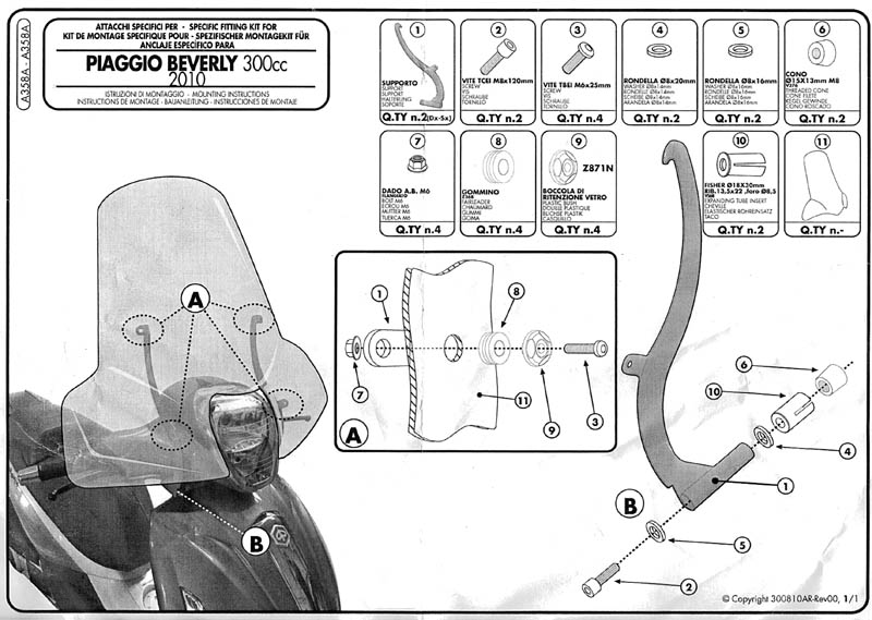

I've just collected my Givi windshield. Will take "before and after" pics when assembled. Also closeups of the kit. Meanwhile here's a scan of the assembly instructions. Looking good
Givi A358A assembly instructions. Givi website says this is good for BV350 also.

Well, the Givi windshield is fitted. It took about one hour in all. No problems.
1) Removed stock windshield (3 screws)
2) Removed mirror stalks to release stock windshield mounts

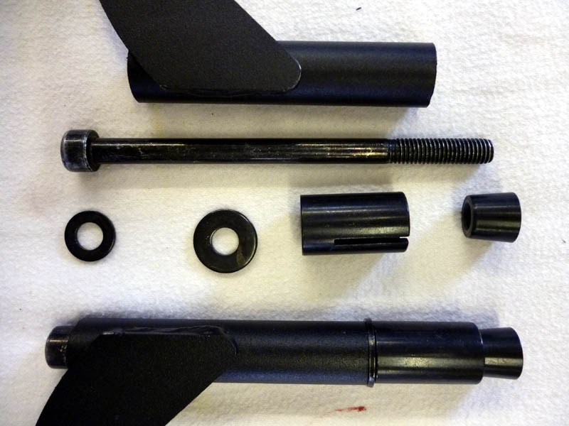

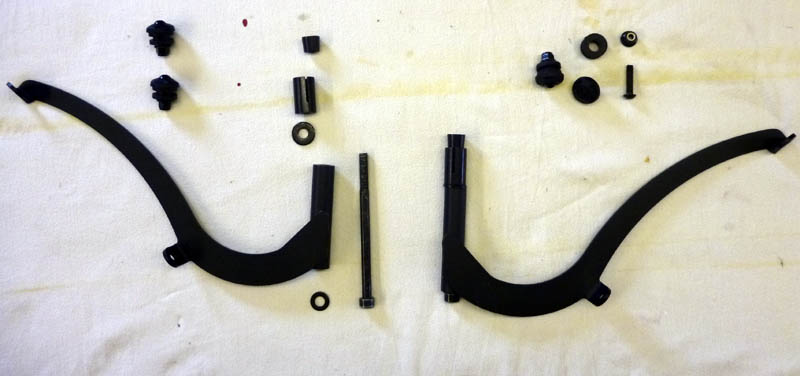

3) Assembled Givi windshield arm components. The windshield mounts in tubes welded to the handlebars thoughtfully provided by Piaggio.
4) Inserted windshield arms into the tubes, giving each bolts a healthy tap with a leather mallet to ensure fully seated.
5) Attached rubber grommets to windscreen.
6) Attached windshield to mounts using collets, nuts & bolts provided.
7) Tightened thes nuts, then tightened the allen bolts on the windshield mounts.
8 ) re-attached and adjusted the rear-view mirrors.

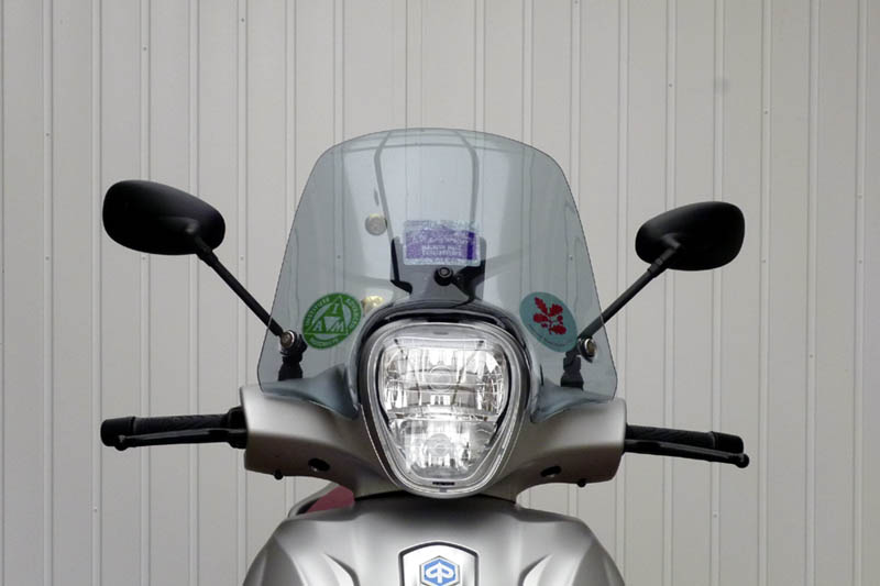

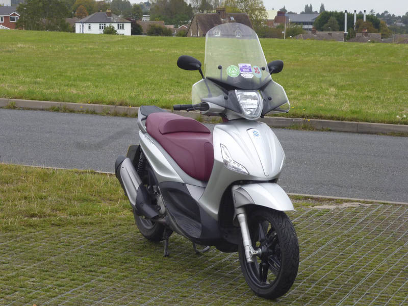

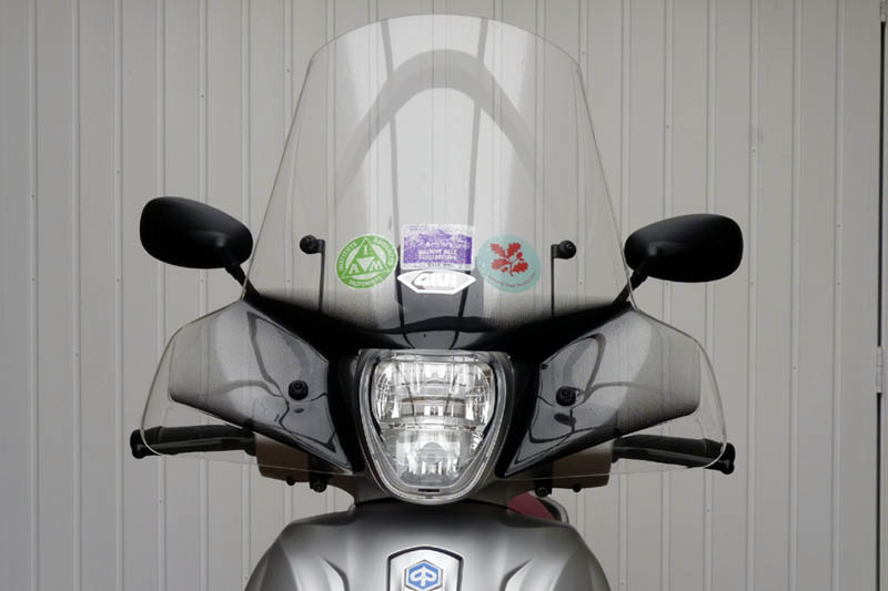

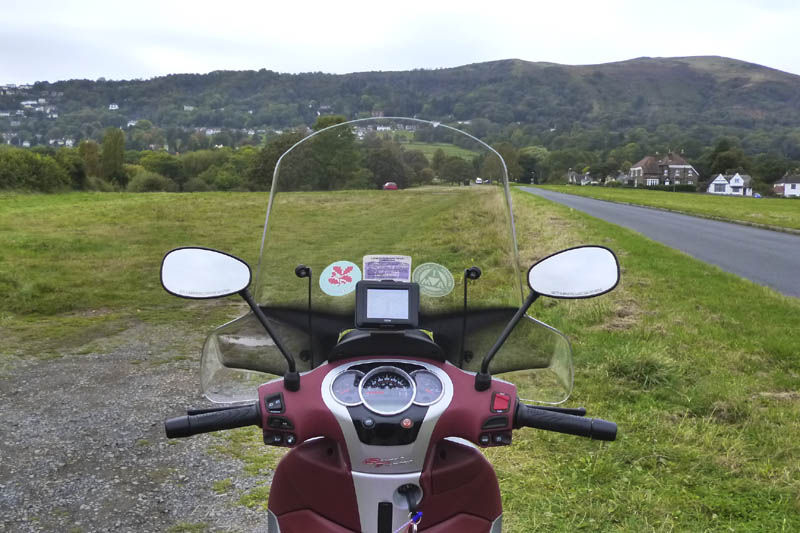

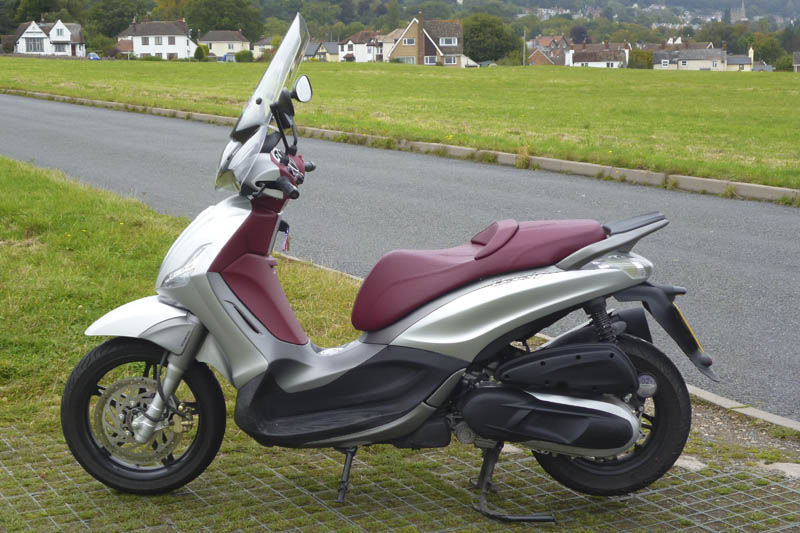

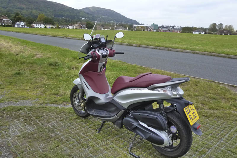

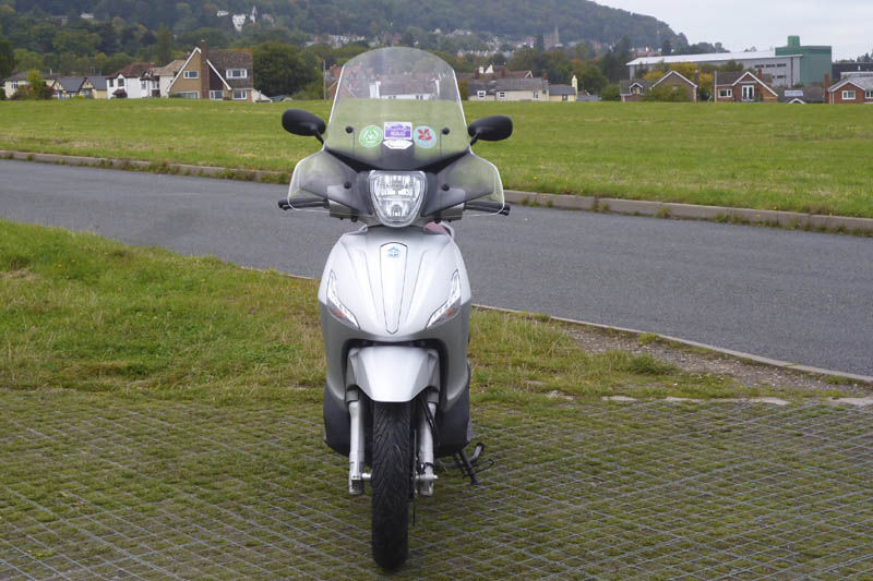

Before - Stock Screen
After - Givi 358A
The two screens side-by-side
Mounting bracket detail
All the widgets

Can you tell us the measurement from the top of the headlight to the top of the windscreen? Doesn't Givi also make a medium windscreen for the 300/350 also? Any idea it's corresponding height?

Yes, Dooglas, the number you want is 18". It is sloping about the same as the stock windscreen so the vertical height of the top of the windscreen from the top of the headlight is about 17".
For comparison, the stock windscreen measures about 10".
Givi do indeed make a medium windscreen but it isn't as wide so does not give hand protection. In fact it's very similar in size to the stock Beverly screen. The Givi website gives its height as 16cm (6.25") less than mine.

Large Givi Windscreen update:
It's raining in jolly old England AGAIN so I decided to test-ride my BV350 with large Givi screen.
Result? - in a word - "cozy". Warm dry hands. Much less wind noise. More engine noise, but that's nice . I'm trying to get used to looking through the windscreen (top 2") although I can stretch up to look over or peer round the side if I have to. Acceleration unaffected. She seems slower because it's quieter but I had no difficulty maintaing 75mph on the motorway. Too early to report on any change in fuel consumption but am monitoring that.

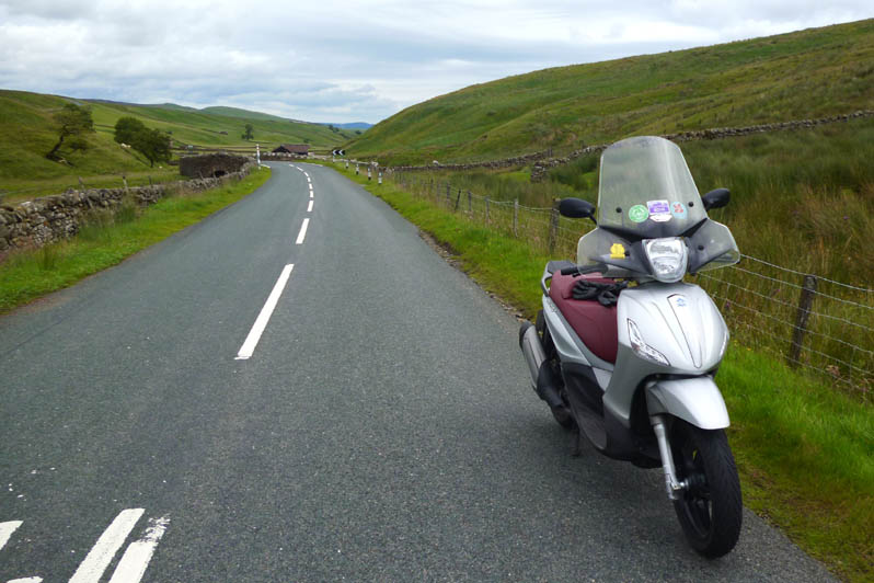

Tue Jul 17, 2012 8:30 am quote
We're enjoying ourselvers in the North Yorkshire Dales. Ride up was wet - but screen was pretty effective. Stiff crosswind on Hartside summit but practically no tug on the steering. Two fill-ups so far - 74mpg (English) so the large screen is costing me less than 3mpg . More tomorrow
In North Yorkshire Dales.

Thu Jul 19, 2012 1:23 pm quote
We're having a lovely trip in North Yorkshire Dales. Beverly's holding her own amongst my brothers' bikes. Can confirm that strong crosswinds do not attack the large Givi windshield. Fuel consumption remains over 75 mpg (English Gallons)
200 mile ride home tomorrow.
John W.
Piaggio BV 350
Joined: 17 Jun 2012
Posts: 557
Location: Cookeville, TN
Thu Jul 19, 2012 4:38 pm quote
Great picture! Looks like a great get away trip!
Good news that the windshield is working out too!

Mon Oct 08, 2012 6:13 am quote
Well, I've lived with my Givi Windscreen for a few months now. I've become increasingly frustrated with peering through a rain-spattered windshield (it's been fine in the dry) - so I "took the bull by the horns" and cut it down by 1.25". I should have done it earlier! I can now see over the top of the windscreen yet it still provides excellent protection from the wind, etc. (my head is still well below the turbulent air flow)
I took the windscreen off the bike, masked both sides and marked a new cut-line on the inside with a fine-tipped black marker. I used a hand fret-saw to make the cut, resting the windscreen face down on a pad of towels. Following advice from elsewhere I then remounted the windscreen on to the bike before sanding the cut edge smooth with my trusty Permagrit Silicon Carbide sanding block.
I am VERY happy with the finished result - both in appearance and functionality.
Regards, John W ( 4,200 miles and counting).

Wed Oct 10, 2012 6:28 am quote
Here are some pictures of my Beverly (BV350) with the cut-down Givi Windshield. I have to say it's just about perfect now - better vision and yet no increase in wind noise or turbulance.
Regards, John W
This is my view of the road ahead
2012 BV 350
Joined: 19 Aug 2008
Posts: 1568
Location: Vestavia Hills, AL
Wed Oct 10, 2012 6:44 am quote
Looks great! You did a nice job with the cut-down.
