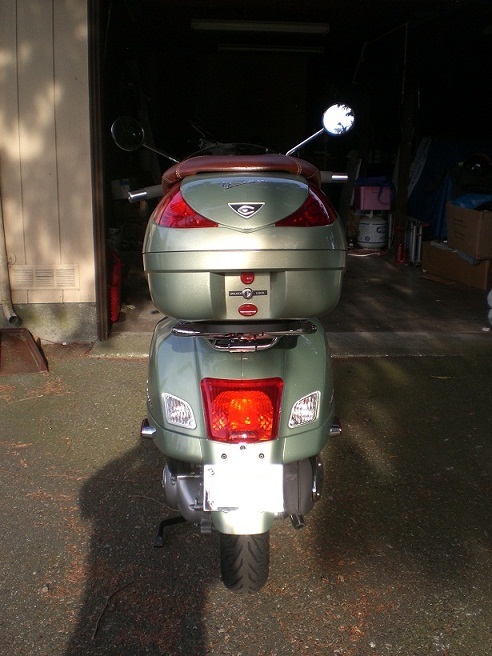

Love that Coocase..
Mikey ~ excellent install! Looking really sharp in black. So does that GTS ....
Yep, it's a bit of work to install, not purely plug n' play but since it's more of
a universal installation, that didn't surprise me too much.I did get all
the lights to work, but as mentioned earlier, they are pretty small, so
are more effective at night then the daytime.
I don't find the alarm all that loud, so I have my doubts about how effective
it is, but I sure like both the remote (which has a folding key built in) and
the ability to remove it if I don't need it.
They also take to a matching paint job pretty good ... all in all, well made
and doing it's job just like I wanted.

Wow. That's the first coocase that I've seen that is 100% painted. Where did you get that done? Was it sent to you like that?
And do you have a picture from the other side? Did you put a Vespa topcase cushion on it?
