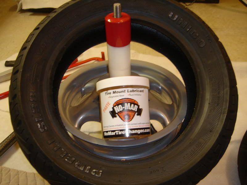

I bought the Harbor Freight Mini Tire Changer for $29.00 (on sale) and the No-Mar Mounting/de-mounting bar for $99.00.
The No-Mar Bar also came with extra tips and lube.

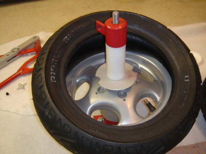

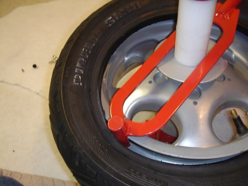

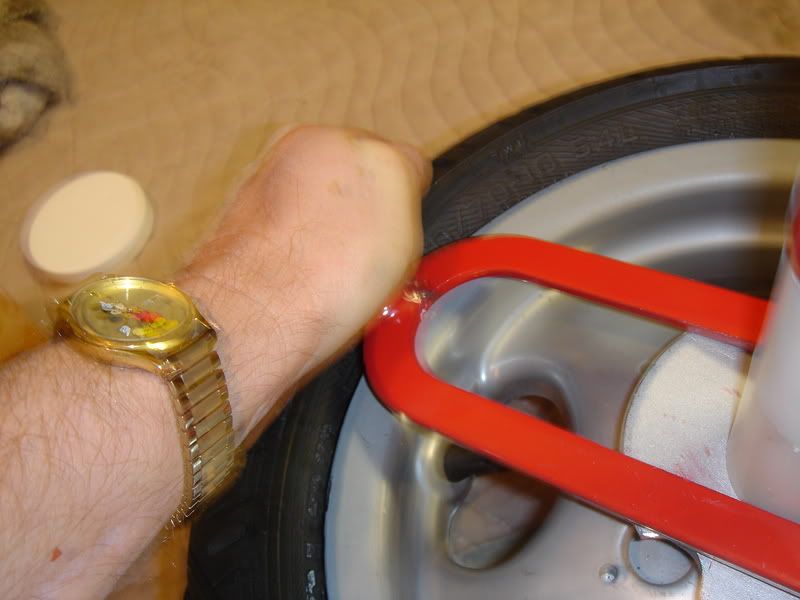

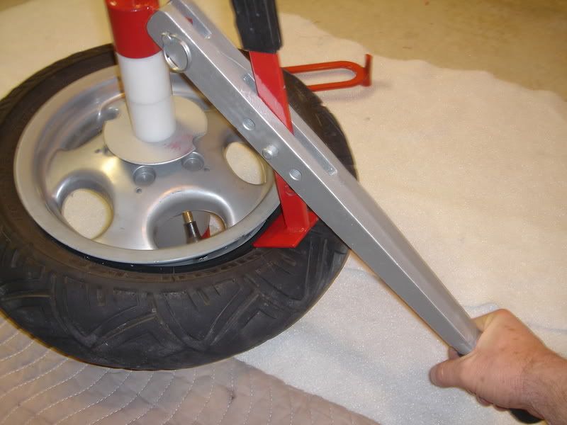

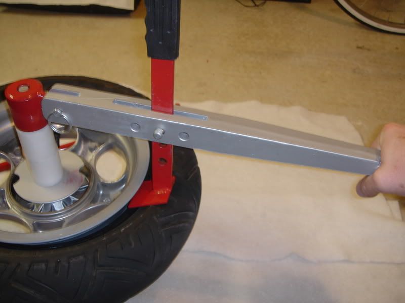

Mount the deflated ET4 tire onto the Tire Changer and use the bead breaker bar to break the bead.
Flip the tire over on the Tire Changer and break the other bead.

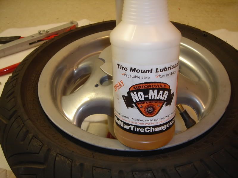

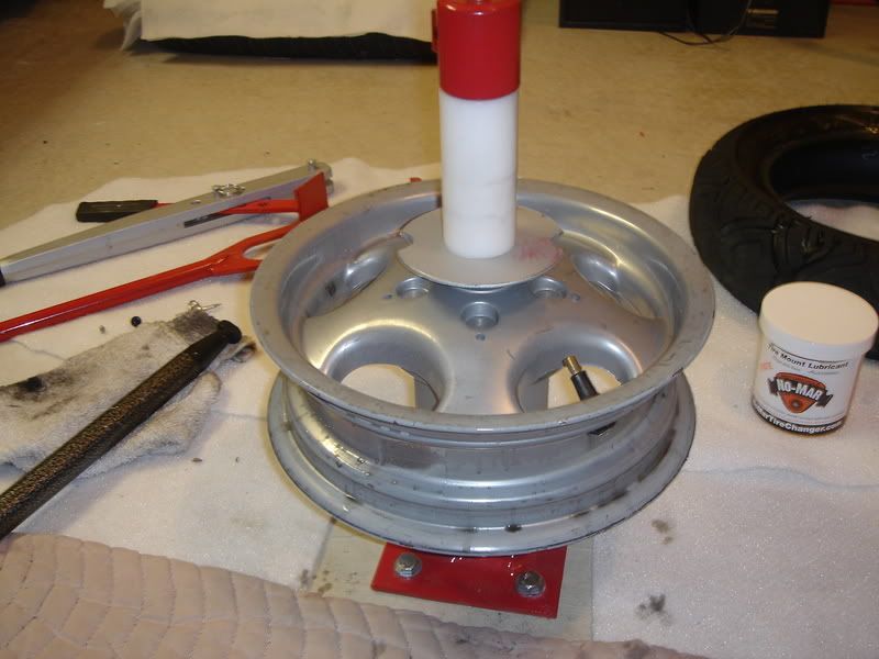

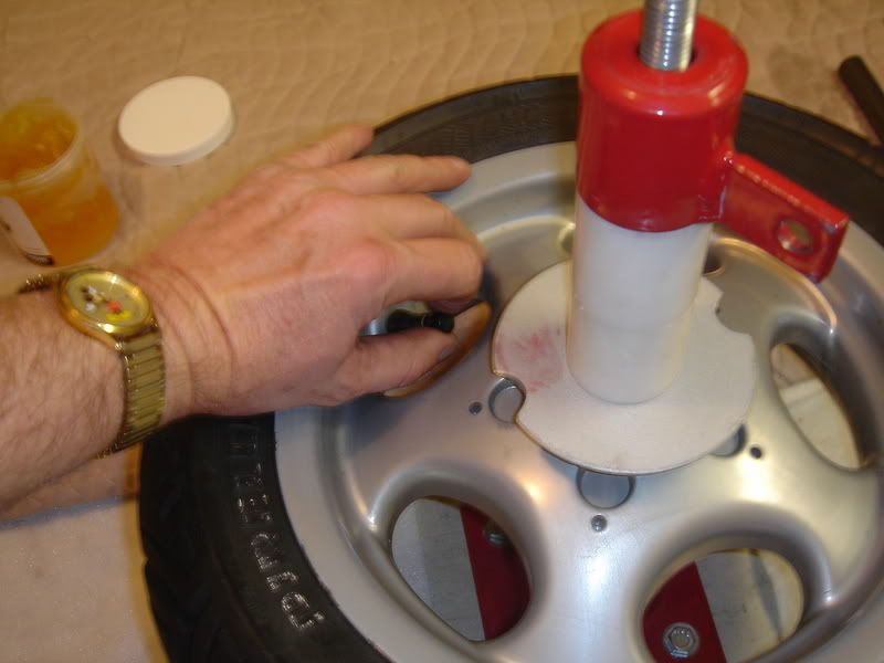

Flip the wheel back on the Tire Changer with the shiny side up. Spray lube between the rim and the tire bead.

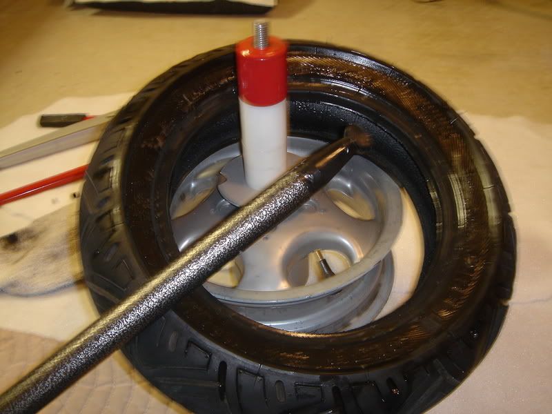

Insert the No-Mar demount bar as shown below. An rotate the bar until the top bead is off of the rim.
Pull the tire up and insert the demount bar as shown being sure to spray plenty of lube to allow the second bead to slip off the rim.
Clean the spray lube from the rim with a rag.
Use the paste lube to lube the inside edge of the bead from 10:00 o'clock to the 2:00 o'clock position.
Push the lubed tire onto the rim as far as you can and keep the bottom bead in the middle of the rim.
Keeping the tire valve at about the 2:00 o'clock position.

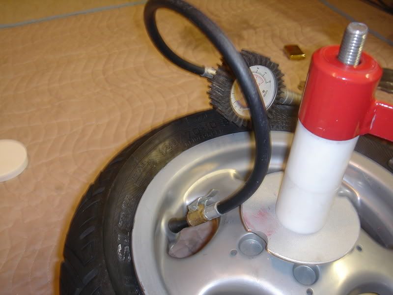

Without inserting the the valve core, blow the tire up to assure both beads are seated on the rim fully.
About 30 to 40 PSI should do it.
Watch you fingers when doing this.
You will likely hear a pop confirming proper seating of the beads.

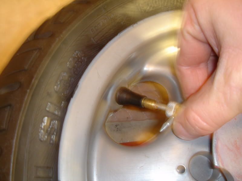

Allow all the air to exhaust from the tire and insert the tire valve core and re-inflate to the proper pressure.

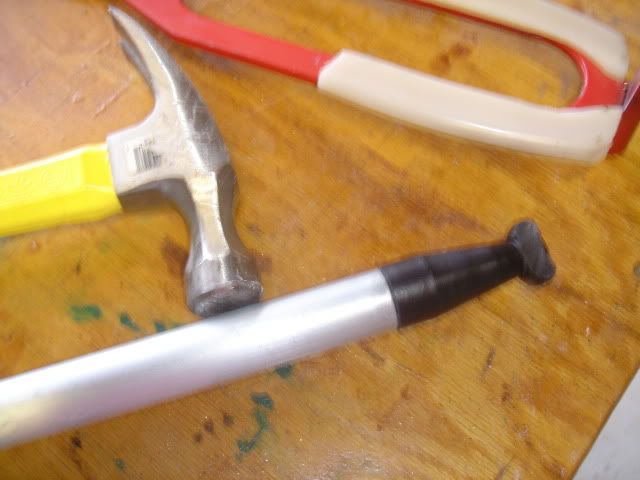

MODIFICATIONS TO THE HARBOR FREIGHT TIRE CHANGER BAR
Below shows how I modified the Harbor Freight Mounting Bar with rim protectors to help
prevent any scratching of rims. Rim protectors can be purchased from many sources.
Here is just a few.
http://www.dual-star.com/index2/Tools/rim_protectors.htm
http://store.themotorcyclezone.com/131-0046.html
Rim Protectors and Harbor Freight Mounting Bar

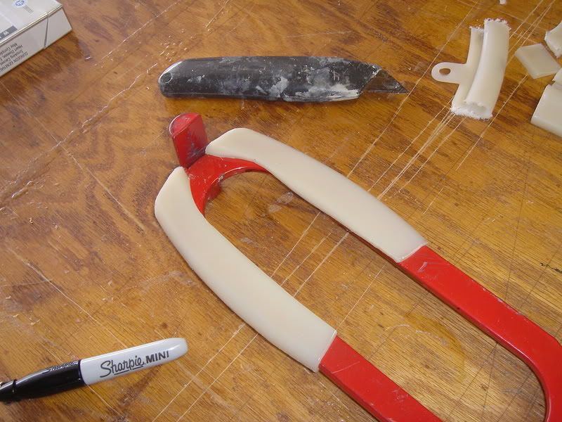

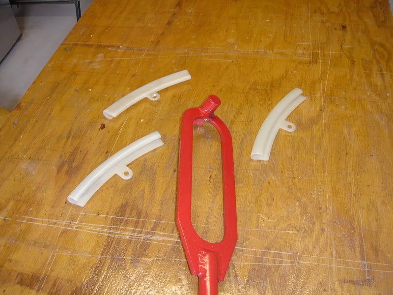

Using a bandsaw and a utility knife, I shaped the rim protectors to fit the shape of the
Harbor Freight Mounting Bar.
Cut Rim Protectors to Fit Mounting Bar
I drilled 1/8" holes in the top side of the rim protectors and mounting bar but not through
the other half of the rim protectors. I used four 1/8" pop rivets (two for each rim protector)
to attach the rim protectors.
Pop Rivet Rim Protectors to Mounting Bar
This is a contact tip from No-Mar that I intent to mount on the demounting end of the
Harbor Freight Bar. More on how to do that later.
No-Mar Contact Tip

Did you use rim guards?

Just thought I'd add my two cents.
The HF tire changer is great for breaking the bead.
A couple of small irons and a small piece of innertube to protect the rim is all I use to demount (lots of soap!)
To install the new tire, I use (again) LOTS of soap, small iron w/ rim protector, BRUTE HUMAN FORCE and a heavy rubber faced tire hammer (to hit tire, not rim)
I have found that the less metal that touches the rim....The better!
BTW line up the yellow mark on the tire with the valve stem.

Fri Aug 07, 2009 1:13 pm quote
I promised to post the modification of the Harbor Freight Mini Tire Bar to
accommodate the No-Mar de-mount tip.
Cut the ball end of the HF bar with a hacksaw leaving a 1/2" long shank remaining.
Taper the end with a file or grinding wheel to eliminate any burs and sharp edges on the HF bar
making sure the two prices fit togeather snugly.
Cut a 1" thin-wall electrical conduit to 10" long.
The conduit really measures 0.91" OD and 0.81ID.
Taper the cut end with a file removing sharp edges.
Push the NO-Mar De-Mounting tip into the conduit.
You will have to use a hammer to persuade the tip completely
into the conduit since the shank diameter of the No-Mar tip is
about 0.002" or 0.003" larger than the ID of the conduit.
Place the conduit with the No-Mar tip onto the end of the Harbor Freight bar
and tap the bar to force the HF tip (1/2") into the hole in the
No-Mar de-mounting tip.
You are ready to change scooter tires without scratching the rims.
If you don't have the No-Mar De-Mounting tip, they can be purchased at the link below. $24 for 3 tips.
http://www.nomar-secure.com/SearchResults.asp?Search=demount+tips+
