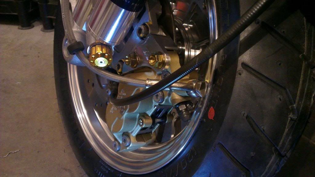

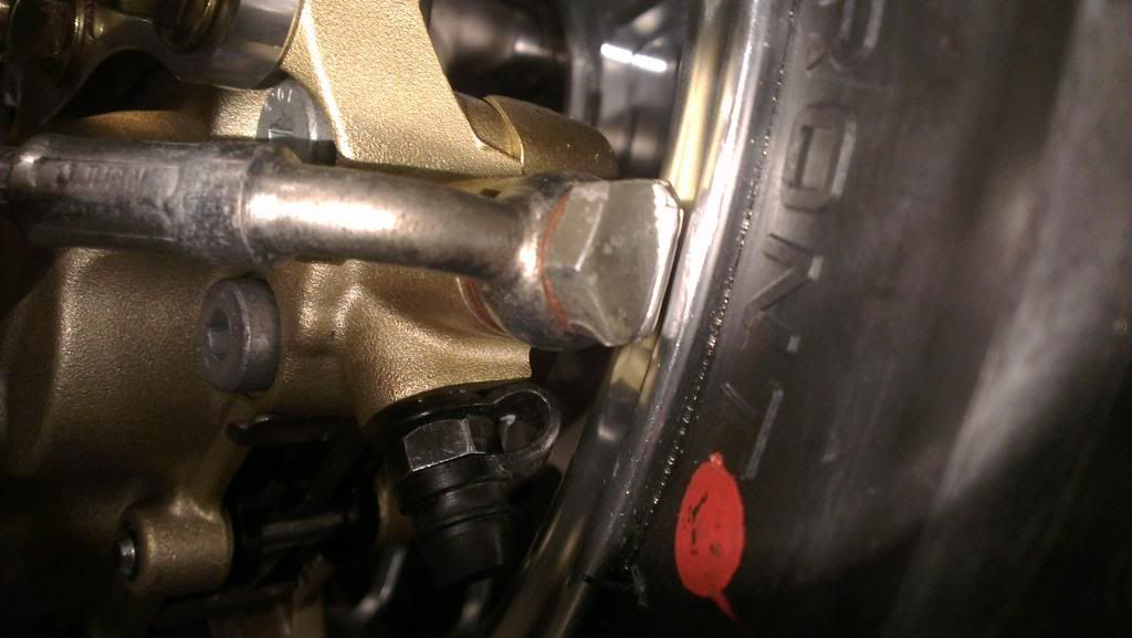

Hi. I fitted a new front caliper to my GTS. When I fitted the caliper banjo it touched the rim. I ground the banjo down but I didn't want to take too much material away. I have clearance, about 1 mm but this is close to the rim but does it matter? The banjo will never touch the rim as it moves with the wheel. What do you guys think?
Also the from brake feels a lot different to the stock brake, is it because there are four pistons, i seems I have more feel. The brake was bled well, it took ages! I haven't test drove the scooter yet.

I had to grind the bolt down a bunch....but not before it scratched the hell out of my powder coating.
You will like it, I consider it a 'must do' mod.

Have the same on my stock rim with a BiTubo shock. Absolutely love it. No damage as it was dealer installed. Why not put a slight offset to your wheel?

Mine is about the same...very very close to the rim.
Have more than 20k miles on it and no problems.
I have the Jettin adapter on the bike currently, but have the same Zelionni adapter in the garage to try.
The Brembo caliper I purchased has the bleeder on top and the 'banjo' below. Hoping it works out better, will report back when I get it onto a bike.

Yes the Bleeder goes on the top and the line on the bottom.

Hi all, thank you for your responces.
The suspension is by Zelioni, looks great and works well too.
Can I ask, so the consensus is that the calliper fitted looks fine and won't cause problems..............
EDIT:
After reading posts - Can someone confirm. I think this caliper is set up incorrectly!
Can I simply swap the bleed valve to the top of the caliper, are they the same thread? I'll give it a go when I get home, dam...........

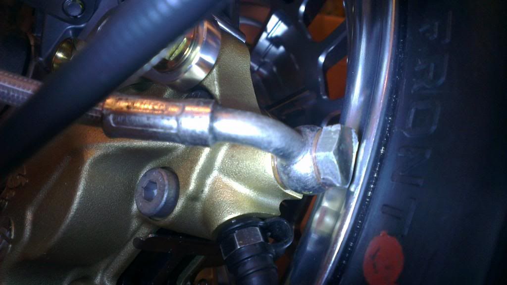

So I managed to get more room to the rim.
And it looks good, but there is a down side............
The bracket is aluminum and I tried to torque it to the brake caliper settings and stripped the thread, no idea why I thought that it would be a good idea. So a new one is ordered, copperslip and a nip with an alan key this time.

yes same threads top and bottom.

To fix this issue I swapped the bleed to the top, this was the obvious place for it due to the caliper and banjo now not clashing with the wheel, therefore new banjo fitted. Bleeding was also better!
I also fixed the stripped thread in the aluminum adapter plate by putting in Helicoils, a lot stronger solution than just the aluminum thread.

Swap the Bleeder
I ordered Brembo Caliper and there are a few other things required including the need to swap the bleeder valve. If you swap the bleeder, you do not need to grind the banjo bolt.

When I put the Jettin adaptor and Brembo on, I didn't have any intereference issue. The banjo is close but not unreasonably close. I've put a couple of hundred miles on it with no issues.

Difference in Adapters
I guess it is the difference between the Zelioni Adapter and the Jettin. When I ordered from SIP Scootershop, it comes with the Zelioni Adapter and they suggest the swap.

The Banjo and bleeder is really close but does not touch.
