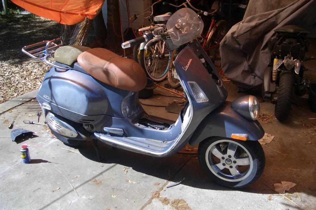

picked up abandoned vespa for super cheap. immediately disassembled to start a part out. but in doing so fell in love with the quality and design. decided to do a custom restoration on it it for fun. follow along if you will. I promise to not disappoint.

Wow... what on Earth happened to cause the seats to be two vastly different colors like that??
Good luck with the project! I look forward to the results.

Look like that seat has been modified, seems to be much comfort then stock GTV seat.
Please let me know if you find anything about seat.

The rear section of seat is dried out original. The front was recovered in vinyl at some point in his life. I bought a wrecked 300 to combine with this scooter. will be using parts from both. will have option of creating GTS 300 or GTV 300. I like those factory big "super" stickers so i will likely be using those. leaning toward the first GTV 300 Super.
would like some opinions on color to go with on the repaint. i am not a fan of metallics so it will be changed to a non metallic color. I also am not a big fan of chrome but do like it in limited trim form. like wheels only. so most of trim will be blacked out. colors i am considering:
