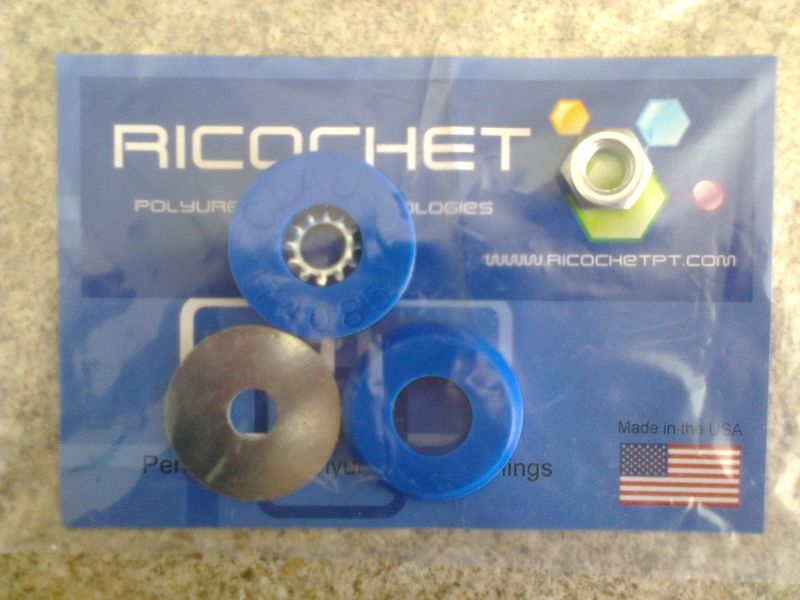

What you get for your $10 or 5 GBP

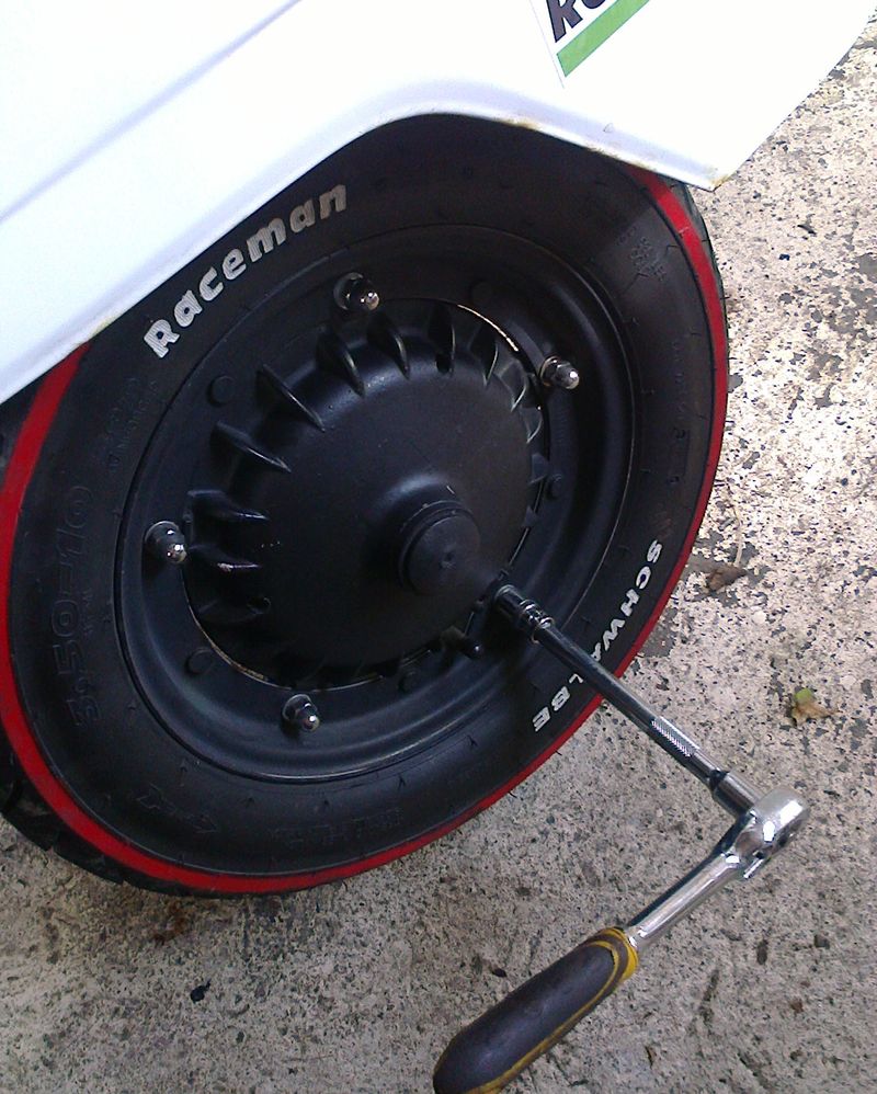

Get that wheel off..

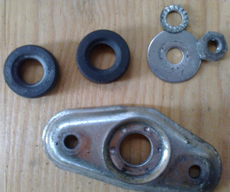

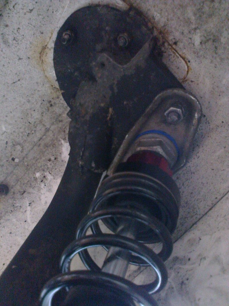

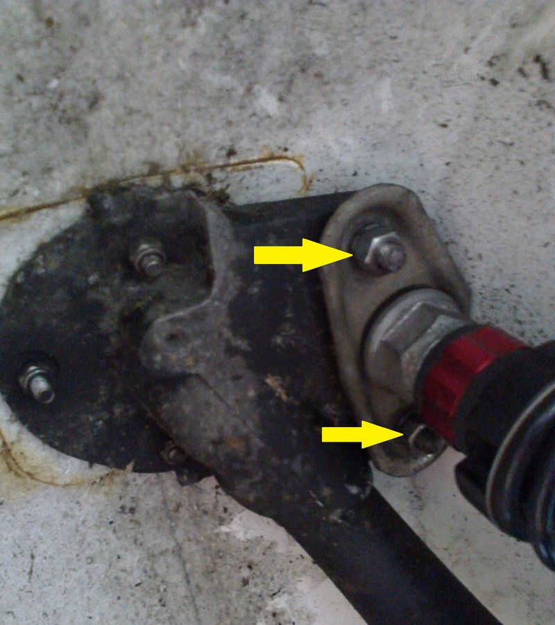

Detatch the shock at the top, only two nuts on captive bolts. Leave the bottom and just swing the shock down so you can work on it.

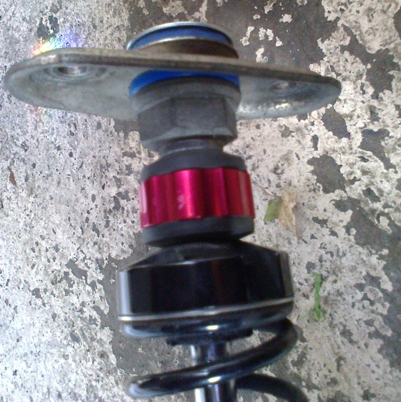

One nut, 17mm I think holds the mounting bracket and rubbers to the top of your shock, take it off and here's what you get. I've had this shock on for a year(ish) but I ride a lot, mostly every day. The rubbers though in tact were soft as shite and felt

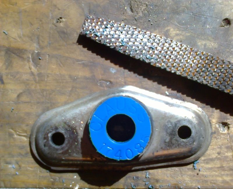

The Clauss Studio rubbers are different to each other, (designed for standard shocks?) so a little shaping's in order to get the bigger of the two to seat nicely in the mount cup - easy done.
