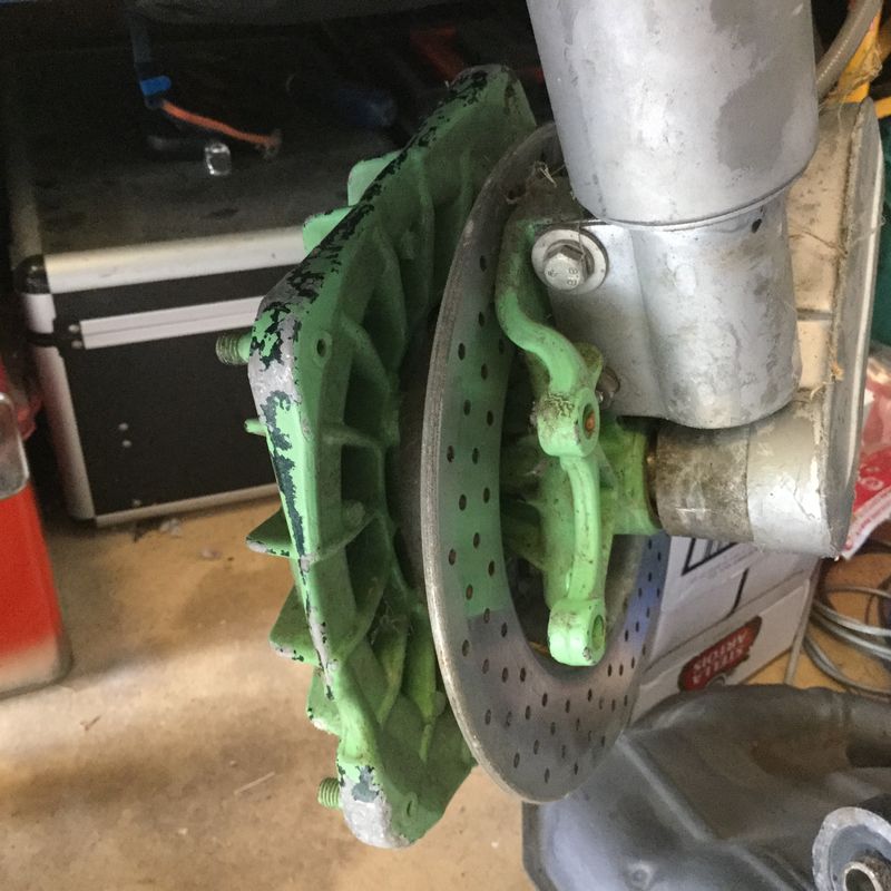

Is that a square wheel hub? Is the wheel square, too?
Seriously, I didn't know wheel hubs ever looked like that.

Think it may be an optical illusion it's like a weird lambretta hub, check out the gearbox

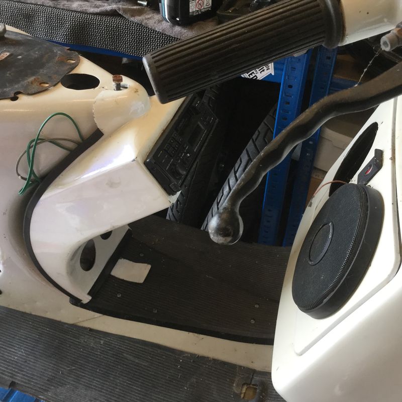

Is that a cassette player? Awesome. Imagine trying to eject the tape to flip it over while driving.

Check out the side panels

You could use a grimeca disc and use the Yamaha master cylinder.
Side panels and stereo are great

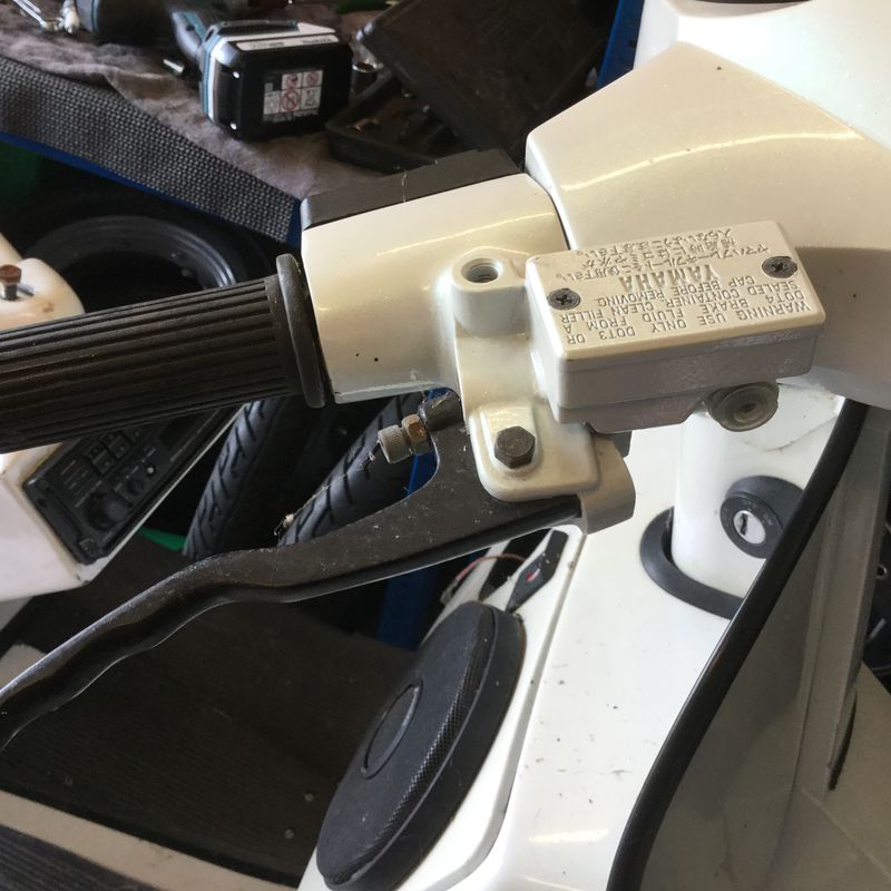

Is that this bit ?

that looks like a remote for a cable to hydraulic. ..... seems like you have the beginnings of another disc setup

That's a grimeca hub. Looks like home brewed master cyl set up

the early grimeca kit has a thiner disk and the caliper has 25mm pistons compared to 30mm in the p98 and newer grimeca kits. I think the grimeca caliper on these early kits is one of the best looking ever made.
Before the P98 master was an option, it was common to weld, bolt, or otherwise modify a motorcycle master to fit.

oopsclunkthud wrote:
before the P98 master was an option, it was common to weld, bolt, or otherwise modify a motorcycle master to fit.
Ooops is right.. I had a similar Yamaha master cylinder fit to my '90's P... clamp on type.. the welded mount you have is much nicer.. That's a well done headset you have.

I wonder why it has flat floor mats like a T5

Yes must have been the look the builder wanted it has the original holes in the floorboard for the runners and a set was in with all the parts

I think the original builder intended to convert the semi hydraulic grimeca system to a fully hydraulic using the yammy lever, will it work?

The rubber mats are probably just for the 80s look. Needs the turbo flywheel cover

IIWY, I'd ditch the semi-hydraulic, remote master cylinder (the previous ownder did a great job of welding that Yamaha master-c to the headset)..
Get one of these brake lines:http://www.sip-scootershop.com/en/products/~/products/brake+hose+spiegler+modular+_30055100
and if you need to, SIP still sell the Grimeca "classic" rotor (looks like you have that, as opposed to the newer NT model)
http://www.sip-scootershop.com/main/base/Details.aspx?ProductNumber=30090000
That's what I ran w/ the Yamaha master-c for about 18 years.. I'm glad they still produce it.
You may be wise to consider a caliper re-build kit (seals) easy to do... OR just buy a new caliper.. after you've cleaned up the Grimeca hub / caliper holder.
I think the PO did a very nice job on that headset..

Didn't know the old style disk was still available. that's cool!
If you can find a local shop does custom brake lines, you can run it through the fork, just like the cable did.
That's the plan Vader , a line and new pads needed , the new condition old ones are rusted but the rest of the calliper and the rotor look good .
