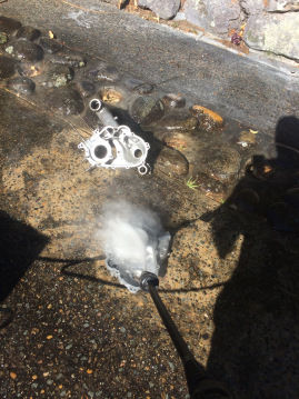

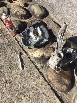

I considered soda or vapour blasting, but in the end (basically while researching different cleaning techniques), did it slowly by hand, with a combination of elbow grease, a wire brush, degreaser, a toothbrush, picks, a gurney, and brake cleaner. This was a pretty time consuming process and I did it in a number of stages, lastly using the brake cleaner externally (from all the research I did, I couldn’t find an issue with it on aluminum) before a final gurney. All in all pretty happy with the final result and ready for reassembly.

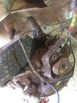

original state...
