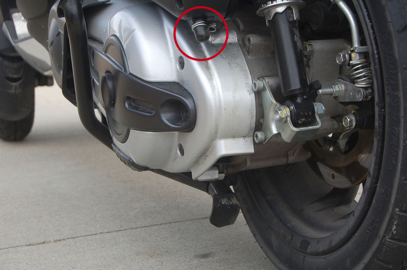

Anyone know what the rubber covers are called that go over this part of the Airbox. I assume this is why I hear a "pffff pfffff pfff pfffff" noise at low RPM's. Would be air passing when it normally has a rubber oil capture bubble/cover which is missing on my bike.

Looks like this will help: FAQ: What's that bubble filled with oil?
Joined: 29 Mar 2008
Posts: 21695
Fri Mar 30, 2018 2:14 am quote
you can order new ones from AF1 racing, they are reasonably priced under $10. don't forget the clamp as I think it is a separate part number.
"Oil Bubble"
This is your indicator, You / Dealer are Overfilling your Bike with to much Oil...
Please visit scooterpartsco.com they are one of the best providers of Piaggio Parts.
https://scooterpartsco.com/piaggio/piaggio-mp3-500/oil-bubble-for-vespa-air-filter-box?zenid=8vh6et5742fes8948ec49rhql6
Search MV for the topics of "Oil Blow"...
Keith,
Marietta, GA
Around $4.00 Each

Perfect, now I know where to buy my bike condoms lol. I mean rubber bubbles.
Thanks everyone for helping me identify the part.
