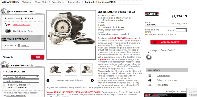

SIP claims this is a factory built engine, not an ebay slapped together with parts off the shelf POS.
Has anyone bought one of these? note the vintage style kick start.
