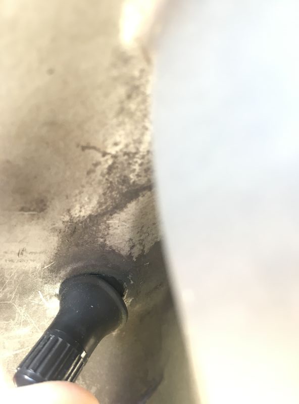

Last year I was riding my Vespa GTS250 on the freeway and suddenly it became difficult to turn, so I pulled off and found out that my tire had gotten flat. I had it towed to my house and found out that if I tried to move the valve stem, it would hiss and leak out air. I couldn't fix it right away because I was going out of town for the winter. But now that I am back, I want to start riding again for the summer.
How do I replace a valve stem for my GTS250? What is a recommended one to replace it with?

What kind of shape is your tire in? Valve stems usually last through 3 or more tire changes.
Try this: You can use a big C clamp. Only pop the bead on one side.
Here's the stem. You can probably buy one from any tire shop:
https://www.ebay.com/itm/Snap-In-Short-Black-Rubber-Valve-Stems-Set-of-4-Kit-Set-TR412/272637537399?epid=782260799&hash=item3f7a76ac77:g:504AAOSwn7JYERPj

I wouldn't put the angled ones on your vespa. Just the standard ones. A friend had her rear tire changed by a MC shop here. They put the angled one on and not very long after it cracked and let the air out of her rear tire. I swap mine out at every tire change. Cheap insurance to prevent the rear tire from going flat.

I checked my service records and I last changed my front tire over five years ago (valve stem was replaced then), but I'm thinking probably due to age and tear it finally broke.
I did order angled valve stems but chrome ones... hopefully they don't bust on me...

Here is a tool you can use to remove the old valve stem and install a new one, without removing the tire:

All of this angst over a valve stem that may well have been torn by twisting it into a position to check air pressure....
Replace it with a new one.

Yesterday, I had the misfortune of replacing two torn valve stems on a large scooter. The big problem with most replacement valve stems on an installed scooter tire is working space. I tore a couple of very good valve stems, and destroyed the threads on another one trying to get my valve stem puller on the head, given the angle I was able to work with. I was able to replace them on the bike, without taking the tires off, using these:
https://scooterpartsco.com/ricambi/misc/valve-stem-set
To get one side of the tire off the bead, I had to use a large thing I got from Buzzetti that looks like a set of pruning shears. I haven't seen them for sale here, and may get some in. There is also a clamp out there that works well to get the tire off the bead, or a C-clamp and some wood can often be put into service. It might be better to use two, one to get the tire away from the rim, enough to get the other one right down on the bead.
