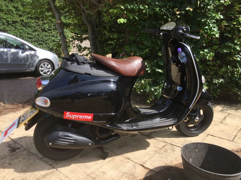

the tank needs a cover making that lifts with the seat .... itd be easy to do with card n fibreglass you could even use the lock then

that is what im actually doing but putting a brown leather dog lead to the catch with no lock and spaying the plastic same colour as the bike

Pipe mod and 85 jet
Just copied warlordsix

delt with
welded

Tyres on
120 70 10 front 130 70 10 rear

Heated Grips
Heated Grips

Dog Lead/ Handle
Made from a dog lead

10k service
polini 17/44 gear up
malossi belt
malossi 8.7g rollers
plug
lead
Did not fit pads as they are still in good condition.
gear oil
eng oil
malossi red filter

make shift mud shield
Used: Monster Energy Can moulded around tyre
Duck Tape
2x Jubilee Clip
Easy clip on for bad weather

Moved battery location
colour code rear trim, seat bucket and respray pipe

Better Mud guard
1x takeaway tin
2x bracket
