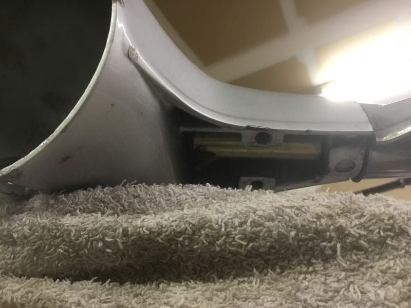

Hoping someone can help me. I have mid 60ís scooter...the handle bar on the clutch side has a bunch of ďslopĒ in it. My question is Iím not totally sure how to get it apart. If I pull the inner clutch cable out and there is a funky clip that goes through the center of the tube....if I pull that clip out will the tube come out? I took a couple of pictures but Iím not sure how good the pictures are. Thanks for the help scott

Yep, pull that clip. It secures the shifter to the tube inside the headset that the gear cables connect to. You might have to twist the pin 45į to pull it. Shine a light on it, youíll figure it out.

Thanks socal...thatís what I was thinking. Scott
