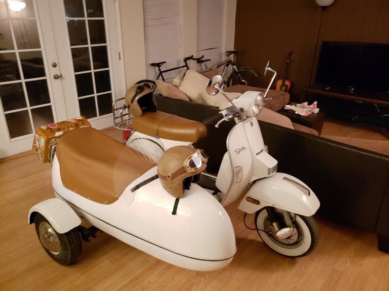

Hi Guys I just finished upgrading my recently purchase 2005 Stella. I bought the Stella and the Sidecar separately.
Just wanted to show you the things I upgraded.
Stella: New front tire White sidewall, and new light assembly.
On the Sidecar: New interior carpet (Brown instead of black). New Vinyl seat and cover. New Windshield (Homemade). New paint job (White matching Stella). car and Frame(Black). New Rear Rack with Traveling storage (Vintage )
Missing installing of light on sidecar fender. and Bluetooth Stereo inside sidecar and Wood dashboard.
Please any suggestions are welcome.
We will take our first ride this Thanksgiving

How did your ride go? That is very sweet looking. I have been interested in a sidecar for my dog but haven't found one cheap enough.

You may want to play with the gearing to get it a little lower. You could do this at the clutch (basket). It will help out on take off and keep you from burning thru clutch plates. It will bring the top speed down to about 45. Good luck and let us know how the ride went.

Goodness that's a great looking scoot/sidecar Poncho.
Classy.
