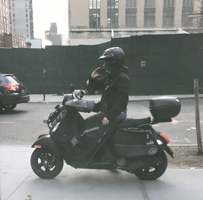

I live on a hill & my new GTS300 blows over in the wind when the cover is on. I’ve decided not to cover it & get the OEM Vespa crash bars, but it seems like they’re only covering a section of the side. Please advise. Thx!

Since you've got saddlebags anyway - don't they touch the ground before the crash bars would?

Fitting side bars is not going to address the issue of your scooter falling over. The best bet is to listen to some of the advice given in response to your earlier post.
FWIW, the opinions on whether crash bars are effective in preventing damage is very much split between members here. I advocate the use of them, but they will only be useful for limiting the dents and scratches to your side cowlings for when your scoot tips over, and some members will claim they don't even do that. They are a costly investment and usually don't increase the re-sale value should you ever decide to sell your scoot.
As Dooglas suggested, you will probably get similar if not better protection from your saddlebags.

The OEM that you have is POS. I still have mine: hanging in the hooks in my garage. I love your front rack though... very cool!
