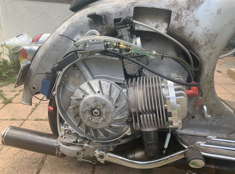

Hi guys l,
Iím after some advice Iím currently setting up the timing on my latest project
Pinasco cases Malossi mhr 210
I have a Ducati cdi with piaggio stator and the pk flywheel that Iíve machined down to 1500g
The issue i have is at 2000 rpm it strobes at 17deg with is where I want it but if I increase the revs to 4000rpm the timing goes to 24deg+
Iím going to try another timing light tomorrow but if I get the same result is it problem with the cdi? Stator? Or flywheel
TI advance for any advice offered as electrical is my weaknes

Have you also machined the flywheel's key slot to fit the P's ignition?? The PK's key slot is at a different position so the pick up trigger "fires" at different degrees...

Yes mate ,the pk flywheel I have is the one with the extra key way cut in and it is installed on the correct key way slot

Hmmm......as well as the keyway difference between the PK and PX isnít there a 4 mm in-out difference on the pick up too? Maybe its that.

I had a BGM stator on a lambretta do the same - most guesses at the time were the pickup was bad. I solved it by going back to points, but I'd look at the pickup for sure.

I had a scooter with the wrong flywheel, behave just like that, that's why I asked for the key's position. Also, as John suggested, a bad pickup could be doing the same...

So this afternoon I tried a different timing light same result
Tried packing up stator by 4mm
Same result
Iím thinking the stator is the problem but donít have a spare to try

I did swap over the cdi but I still had the same problem but I didnít have a spare stator to test so Ifitted the sip vape ignition now and am going to have the piaggio stator checked via a local scooterist who is a electrical guru and keep as a back up for my other Vespa

I believe this was discussed somewhere, maybe the old Stella Speed forum. The standard CDI is basically wrong at lower rpms. At idle rpms itís retarded. As rpms increase toward 2500-3000, it advances and from there on out pretty much stays the same.
The later PX150 Service Manual specifies that the timing should be checked at 3000 rpms. This alone suggests that timing measurements below that should not to be used.
