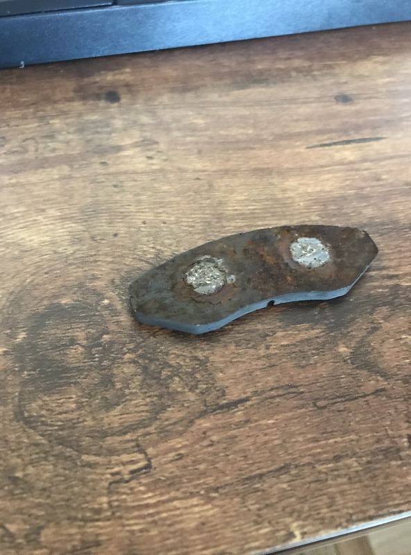

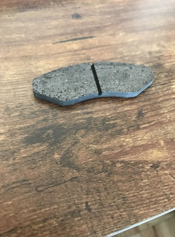

Something really odd happened to me yesterday. When i was backing out of a parking spot, one of my two front brake pads fell out!!!! It was really scary thought if I were riding and it fell out.javascript:emoticon('') Only one of the two pads fell out, however, with one pad there is zero braking power on the front wheel. I have ordered new brake pads, but it scares me to think such thing can actually happen. Does anyone know if this has happened to anyone before? I took a picture of my break pad and it broke away from the housing that it was welded/glued on. Please refer to the photo. In other words the housing for the front brake pad is still there, the metal part, but the actual brake pad broke off. I have not changed my pads for a while, but they were not worn out. Should we change these pads every year?

What's the backing plate look like? Quick Google search says rust is the cause.

There is very little wear on this pad so I would guess it has been replaced quite recently. Possibly a poor quality pattern part? If you clean up the backing plate can you see any manufacturers name or part number?

I am changing the pads this weekend. I will see who the manufacturer is. it should be OEM...
I guess we really shouldn't ride our vespas in the winter time because of the salt, etc, it rusts out bike scooter...

Unfortunately, this is pretty normal with Heng Tong (Piaggio OEM supplier)...

one of my mp3 pads did this. it was marked ferodo on the pad. it still brake fine though as pad was trapped in caliper. replaced with ebc and very happy with them. the blue pad is stock from piaggio. I wouldnt worry too much about it happening again.
i dont think rust is the cause. this likely happens when pad is good and hot then suddenly cooled. the rust happens after is breaks off.

Under normal circumstances I'd say it's a silly idea, but it does beg the question with the evidence. OTOH, I'd guess the failure could happen at any time. Maybe it's just the picture (or me), but I'm not seeing corrosion.
If this is a not uncommon issue as SaFiS states, it's a bit scary. Not having brakes when you need them could get somebody hurt...or killed.

I guess that might be caused by ice. It "sticks" the friction pad to the brake disk

Ice may be stronger than glue!
Don't set parking brakes when you're parked in an area where ice may form.
