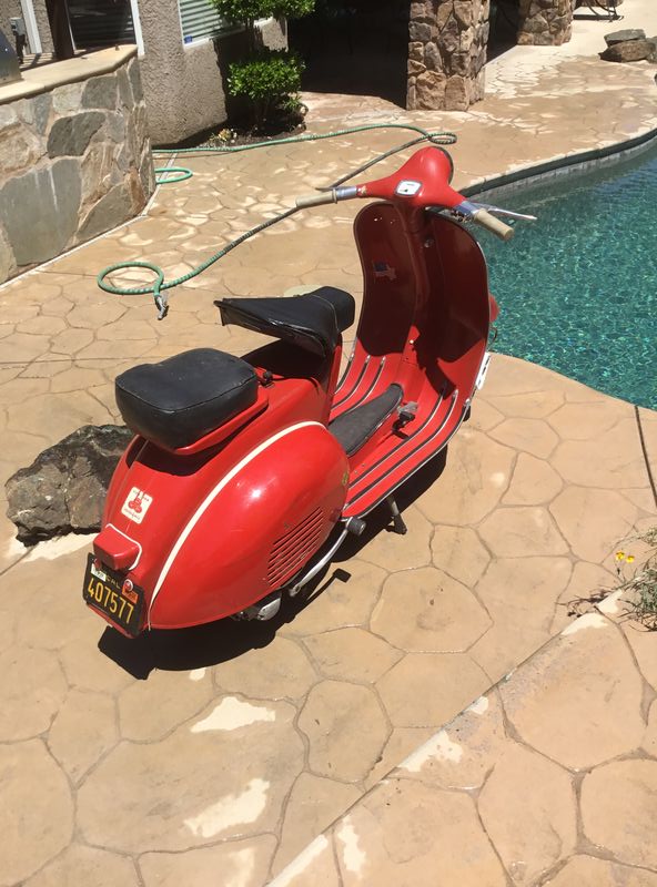

Well I posted awhile back about a problem I have with the tail lights on my 64. The brake light seems to work ok, but the running light keeps blowing. As soon as I rev the engine, the voltage skyrockets and another blown bulb.
I took the advice of some MVF members. I replaced the running light with a 10 watt bulb instead of 5 watt. Did not work....is it possible that the stator can put out too much voltage? I do realize there is no voltage regulator and the voltage is controlled by the load, but the voltage goes crazy when the engine is revved. Any help is appreciated. Thanks scott

The brake light has its own coil in the stator. Most likely it needs to be replaced.

Maybe I misled you...the brake light works...it is the running light that is blowing. Scott

Well the response was not what I expected. How about has anybody tried to add a voltage regulator to a ciruit, because of a voltage surplus? Any help would be great. Scott

Yes people have added a regulator, there were a number of threads some time ago. The regulator that I bookmarked at the time was this one. I recall someone said all they did is add it to the system, didn't matter where apparently and worked well.

I tried a dozen different bulb combinations and couldnít get the tail light on my smallie to stop blowing.
Finally wired this little guy in to the tail light circuit at the junction box. Never blown a bulb since.
https://www.treatland.tv/yamaha-FS1-6V-regulator-p/yamaha-fs1-6v-regulator.htm

^^^ This, those semi cheapo voltage regs work well. I may have one I can send you.
