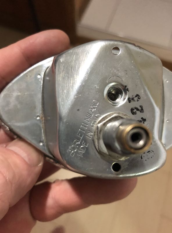

I have a recently bought a Vespa speedometer that the seller posted as a GS160 original speedometer. The face plate is in mph. A knowledgeable, reliable person who knows about Vespa speedometers, pointed out to me that the speedometer I have is definitely a VBB and not a GS160. This is due to the face plate being 60 mph. I do notice, however, that a small diameter GS160 cable fits correctly into the back of the threaded cable hole and will move the needle when turned.
He claims the GS160 was 80 mph. I asked the seller about this and he is adamant that it came out of a 1962 GS160 and that the top speed for this year model was 62 mph. I don't dispute the top speed being 62 mph, but I would like to confirm if any GS160 bikes ever came with a speedometer plate showing 60 mph. I can't find any photos on the web. They are all either 80 mph or 120 kph. If anyone has a GS160 with a 60 mph speedometer or knows something definitive, I'd appreciate it. It's not a blame game, I just want to know so I can either keep it or sell it.

I don't know that I have all of the answer your looking for but that is the exact speedometer that is in my 1963 VBB, I purchased the scooter in rough shape so I doubt it was replaced prior to me and from the looks of it being so faded Im guessing it's the original. Its difficult to see in the photo but it is a 60 MPH speedo.

That's what I was afraid of. It's my fault for just reading the vendor's ad and not thinking about the face plate numbers. Caveat emptor. It might be a case of the vendor not intentionally deceiving and me just not paying enough attention to details.
Unless it's some kind of one-off oddity that Piaggio did with the GS160 for a year, I'm pretty sure now I'm stuck with a VBB speedometer. I'm having Steve Burdette (Speedo King) rebuild the internals, so if anyone wants to buy a nicely restored VBB speedometer, let me know and we can make a deal.

Based on the bezel, it looks to me that someone has opened up the speedo. It s possible they replaced the mechanism to work with GS cable.

No, when I got it, it appeared to have never been opened. I opened it to change the lens that had a small crack in it. This is the main reason why I have not asked the seller for a refund. It's a good question though. I wonder if the VBB cable end is super small like the GS160 cable end. The whole experience has been an all round self-inflicted

If I recall, When I replaced the speedometer cable on the VBB I had to get the small end cable. I can look further if you really want to know.

My VBA speedo goes to 120kmh (80mph). Iím pretty sure itís original too. The bikes completely unmolested.

No, that's ok. Speedometer cables are usually trouble, so when they work, it's best to leave them alone. I'm convinced now that what I have is not a GS160 speedometer, but most likely a VBB speedometer.
