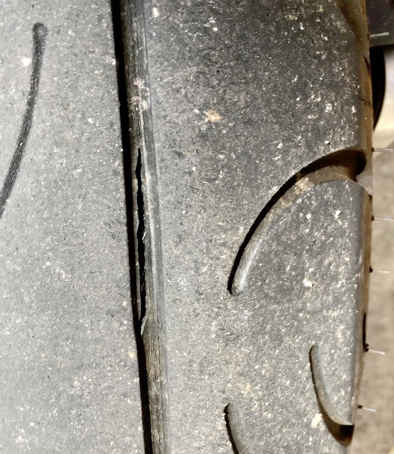

So I found this slice in my front tire today before riding out. The tire is a Heidenou K-61 with about 11,000 miles on it, but it seems to have plenty of rubber left on it. Maybe just too old? It's probably 6 years old? What would you do? I'm guessing I need to replace it?

Replace it ASAP. Six years is past the recommended tire life of five years. 11K miles on it, it doesn't owe you a thing. Say bye bye.

Yes. It's trying to tell you something. Get rid of it. The micro cracks just below the slice says to me 'old age'.

Yea-I hear ya. Really more of a rhetorical question. Bike has been sitting over the cold months and first chance to enjoy the warmer weather, I inspected both tires and took a look at the hoses. Found that slice in the front tire and well... gonna order a new one. Hope everyone takes the time to take a long look over the bike before any longer rides. Spring is a good time to check that bike over REALLY well.

Good reminder. Looks plenty unsafe to ride on to me.
2019 is a tire year for me.....GTS needs a set, replacements ready and waiting, BV's tires look good but still original. Probably wait until riding season is mostly over to tackle those. I don't want to have to share any photos like that one!

Looks bad. Most only get about 10K on front and 6-7K on back. I was able to save myself about $100 by removing the wheels myself and have a local shop (not a dealer) mount and balance the tires and I reinstalled the wheels (you need a torque wrench to do it right). They had better pricing than online for the tires. It was nice to support a local biz too.

That is not a slice, it is a crack from the tire starting to fail.

Looks like a blow-out waiting to happen. Don't ride it, except maybe a short hop at slow speed to the shop to get it changed.

No, the back tire was replaced late last year just before the cold hit here and has just a couple hundred miles on it. I plan on taking the wheel off myself and taking the rim and new tire to be mounted and balanced at a local shop today or tomorrow. PLEASE check out all your rubber components after storing the bike for the Winter months! Ya never know what dangers you might find.
