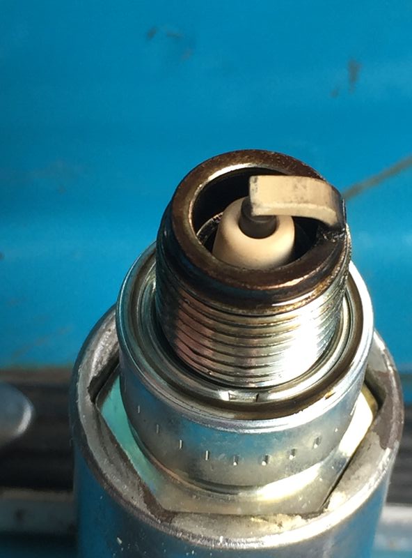

Put a few more miles on the Chetak with the 45-140 pilot and 120AC BE3 130MJ. Seems pretty good had a few open spaces sustaining speed at 50, 55 and 60. It all feels excellent so much power on tap. Idle seems good a little rough in the mid range.
This is the hot plug at WOT in 2nd gear.

What does the CHT read when you hold it where it's rough in midrange?

Don’t have a CHT gauge darn it. Plug color is tan on ground strap and slightly more color on opposite side on porcelain. Does it look too lite?
Still a slight gap at crossover.
Turned air fuel to 2 1/2 took another picture.

If this was a 4 stroke motor I would say you're jetted nicely , not starving for and and using it all. Sorry I'm really just learning about these 2 stroke engines so I'll just sit back and see if I can learn something.

Second picture looking better. No CHT. Do a sound recording while riding. Tickover to fast through the years.

Plug from regular shut down looks to be a dryer black on shell and very dark on insulator. To me it looks dryer and darker it runs very good need to give it some miles. Wiped plug shell clean and installed.

Still looks pretty rich to me. Another main drop or two to go, maybe three.

Looks rich to me too. 55/160 is too rich at the bottom. 48/140 would be the next to try.

Shocked but pleased to see brown again on the cold plug following the ride.

Sat Jun 20, 2020 7:11 am quote
Don't have a 50/140.
A little confused on the jet ratio. If a 50/140 pilot provides a 2.8 ratio would that make it richer than the 55/160 @ 2.9?
A 50/160 ratio is 3.2 and 4 jet sizes (Vivo chart 38/120-3.158) leaner than a 55/160-2.9.

Sat Jun 20, 2020 12:07 pm quote
When fine tuning that chart doesn't work. It gets it close but won't get it smooth.
50/140 is the next one to try. If it was only just coughing at 1/4, it should be enough.
Do you have any 50 pilots?

Finally got a 50-160 pilot and went for a 50 mile ride down PCH. A quick ride around the neighborhood seemed fine but on the highway not so good. Had the 1/4 throttle cough again felt in 4th gear where you'd want to cruise. Had to throttle past to keep things happy and go faster than want. Air fuel was at 2-1/2 turns. Everything feels good except 4th gear cough. Going to put the 55-160 back in, it feels better and sounds better but need to run at 2 turns on the air fuel.
Think I'm having another problem when fuel level goes to reserve. Seems the float bowl runs out. The scooter might run a bit and then just die out of gas. Needs choke to start again. If run scooter fast it empties quick. Everything is fine until tank hits reserve level then things act up.
Removed fuel tank and observed decent flow from valve. Could not observe above reserve flow didn't have enough fuel but reserve flow looks ok.
I'm using a SIP XL tank it's a P bottom and Rally top. Wondering if the tank bottom has created a below carb level symptom? I think the standard tank bottom might be much higher giving better pressure?

Sun Aug 09, 2020 11:03 pm quote
50/140 is what was said before. Did you get one of those too?
Electric fuel pump under the tank will fix it. Just something small will be enough.
