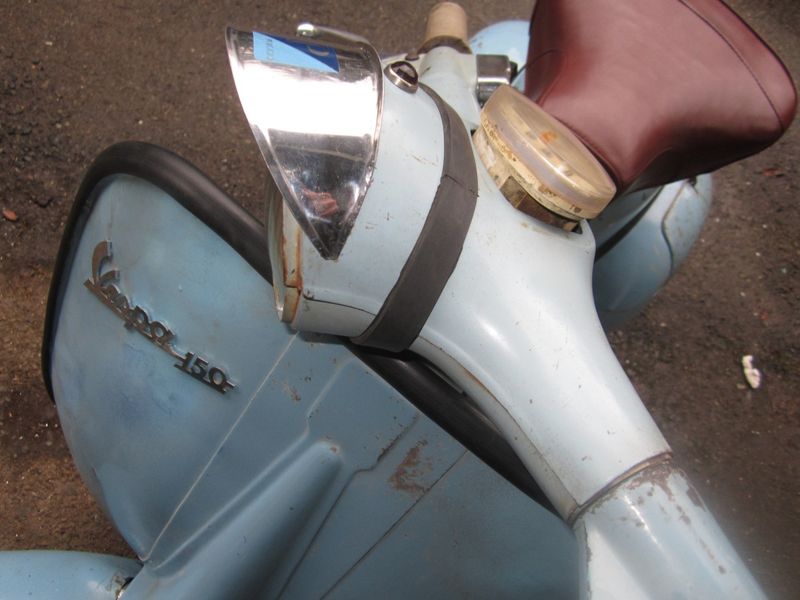

Had the legshield welded today.
Unfortunately, the weld on the front cracked again on the way home. The one on the back has helt until now.
What to do? Continue like this? Or have it welded again first?
Before
During
During
During
After the ride home. The weld on the front of the shield cracked again.
The one on the back has helt for the moment. It's great to ride without resonance!

Fri Jun 14, 2019 11:31 am quote
To be honest, that was not a good welding job. It was just tacked and was destined to crack again. It needs full stitch welding to fill the whole crack.
74 50s x3 78 P200 84 Cosa PK50XL2 58 AllState 68 Sprint 80 50special '66(?) Super125
Joined: 22 Nov 2010
Posts: 7735
Fri Jun 14, 2019 11:58 am quote
+1, but was a good start. I'll bet you didn't want any of that original paint ground down/burned up, but it's gotta be done sometime. Sorry, I feel for you and I have been there too.
stick welded and not very pretty but has taken the vibration etc for a couple of years now without breaking.
hammer & dolly time then a little fiberglass cosmetic help, very little
done enough for me and was time to change some things on that silly headset
edit: aw geez , I already posted some of this on Pg1, as well as this prediction:
V oodoo wrote:
You'll want a full weld to do it right and not have it crack before long. Find an autobody shop w/ somebody experienced in welding body panels. This should be easy to get a good job. Wet rags to protect the paint maybe, but this will burn it back a little. No worries paintwise, it would add to its charming personality Grind, polish and clearcoat, maybe w/ some blue tint.

You are both right, I didn't wanted to mess up the paint along the whole crack.
I would be happy with just a spot. Or even 2-3 spots, but it has to hold.. That's the problem.
