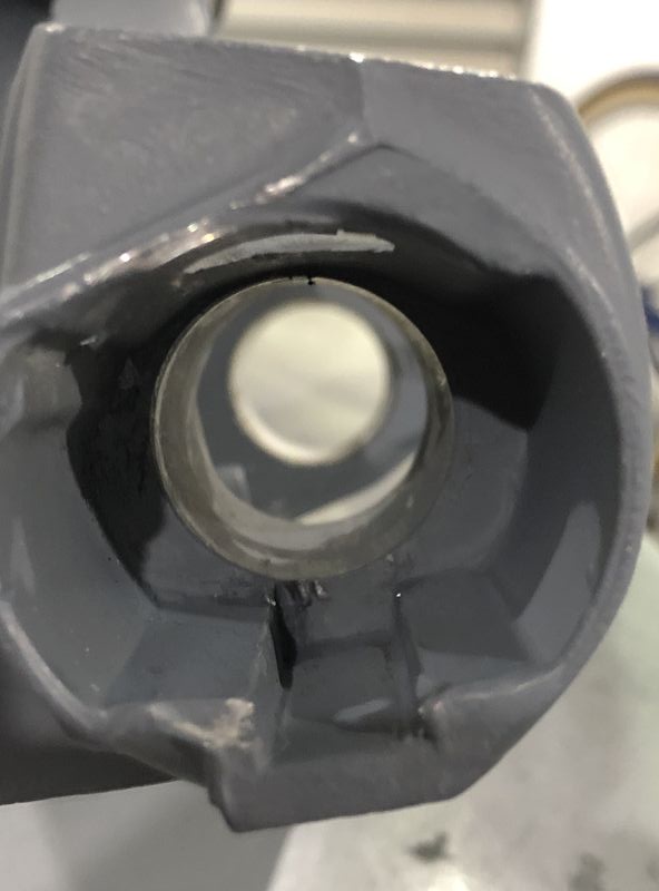

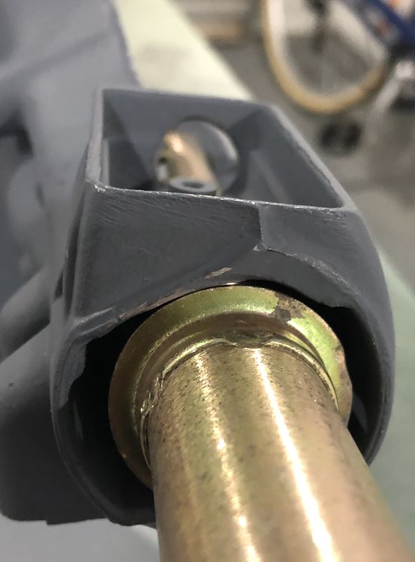

Can you help I have a disc brake front end and wonder if I am missing a critical part because the throttle tube does not turn freely.I have attached some pictures if someone may tell me whats missing.I have the plastic bushes and fittings but its the open end that is my mystery.....

If you have the plastic bushings then you have an LML headset. It's possible that the flange on an LML tube is not as wide... grind it smaller.
