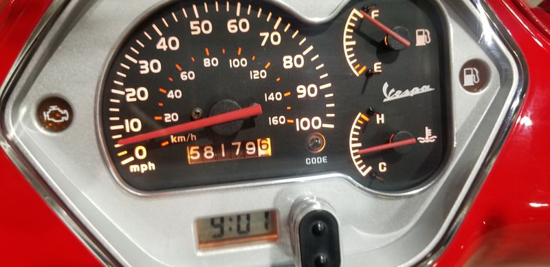

Any recommendations on aftermarket front suspension for the GTS 300 ? Mine almost 60,000 miles.
