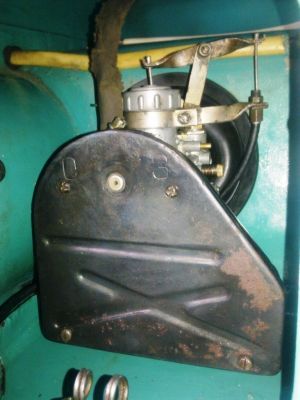

I have Vespa 150 VB1.
It has such Air Cleaner Box.
Air Cleaner Box has Air Cleaner Filter from metallic net.
I donít complacent this.
In Frame has small box for Air Cleaner Filter.
I can not use Big Air Cleaner Box.
How can I change my Air Cleaner Box?

Are you sure this is the stock carb?

For better understanding of your question do you have a picture of the small air filter box you stated? Is the picture above the large air filter box?
..and yes type of carb does matter sometimes.

Air filter box is original Vespa 150 VB1.
This pircture is from spare parts Vespa 150 VB1.
Carb is also from Vespa 150 VB1.
I think that stock Air Filter filter air very bad.
I want to change it.
In Frame has small box for Air Cleaner Filter Box.
Were decisions this problem?
Vespa 150 VB1 Engine

Why is the air filter box not working? You can clean the mesh filter or replace with new or a filter made from a different material like nylon, polyester or etc. Just Google "air filter box material".

74 50s x3 78 P200 84 Cosa 58 AllState 68 Sprint 80 50special + projects
Joined: 22 Nov 2010
Posts: 7513
Sat Aug 10, 2019 10:15 pm quote
You just need a slim filter to fit in the space under your seat, behind the door?
I used a modified SI24 filter on a PHBL25 that's pretty thin and fits easily in the VB1 space. Seems to give the motor plenty of air
Plenty of room for coil & regulator too.
