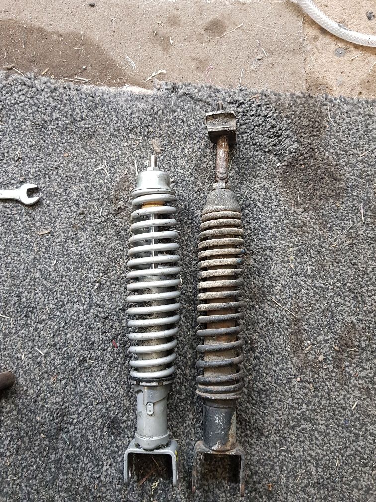

Hi amongst some other jobs I've just attempted to replace what looks like the original rear shock (1989 TX200) and failed miserably. The replacement shock is nearly new and from a px but when I removed the original its about 3-4 inches longer primarily due to the rod length at the top after the spring. Anybody else succeeded in swapping this unit over?
Thanks in advance AL

Sorry for wasting anybody's time I've just found that an extension piece is readily available so i'll order one up

I was just gonna tell you about those extension connectors in various lengths, but no waste of time. Did not know of TX200 and now I do. Thanks!
