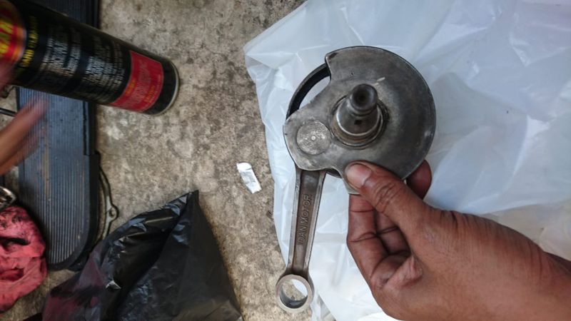

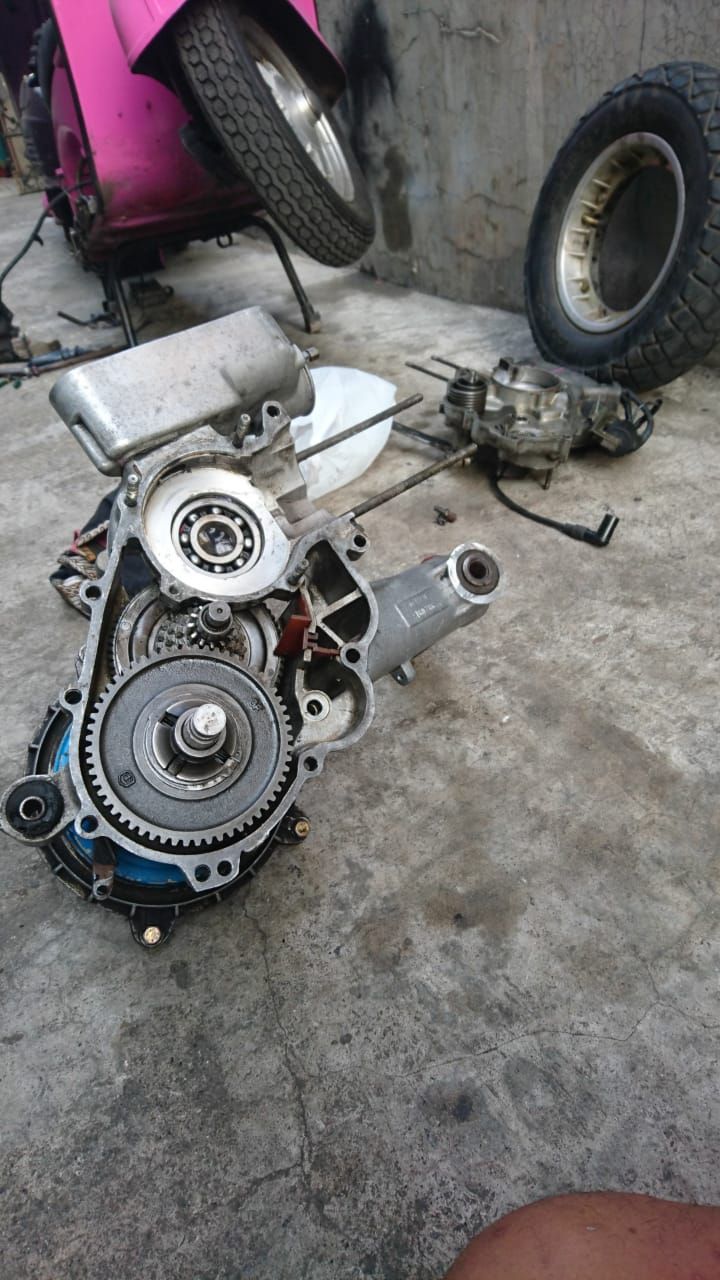

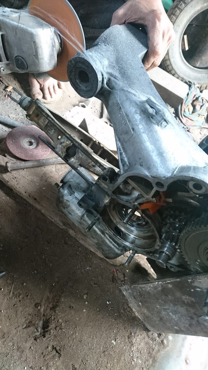

so last weekend i open up the engine to fix the twisted crank shaft, cut the engine mounting, change the bearing and crankshaft seal, grind the pipe (again) and now the tyre can fit in the pink happily
cut as much as i can
change the seal and fix the twisted crankshaft

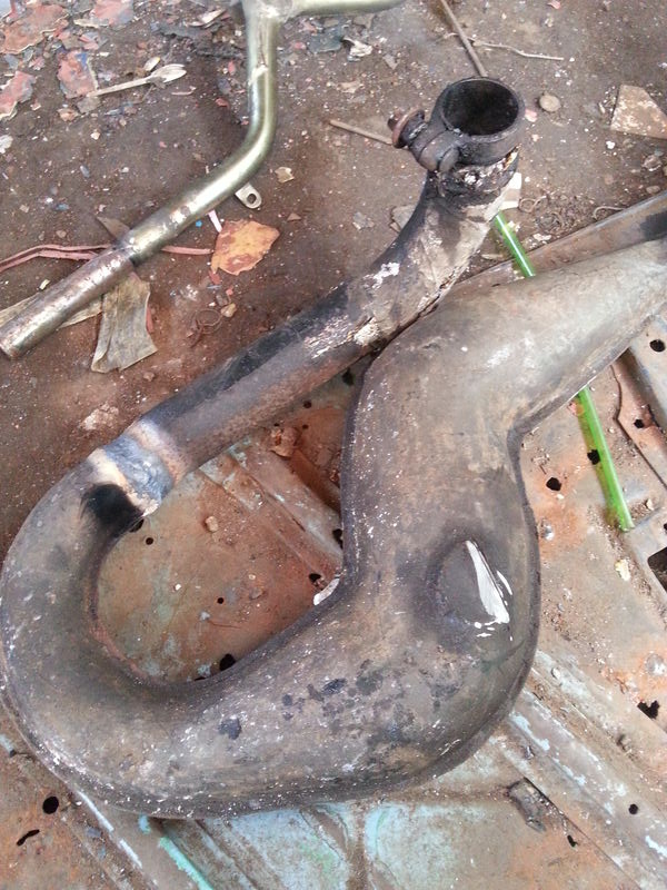

last one can hold for 6 years, hope this one will last longer

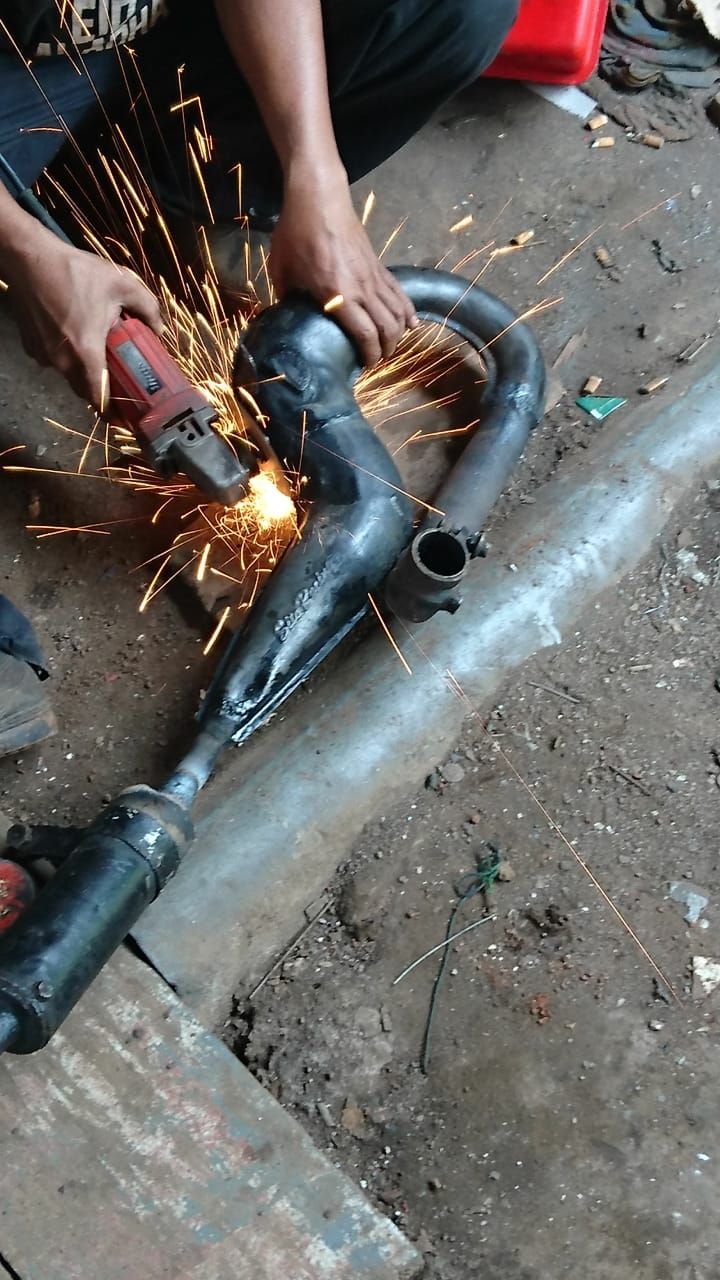

cut the pipe (again)

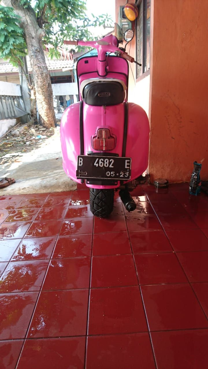

put the engine back and boy.. it sure does tight inside the cowl

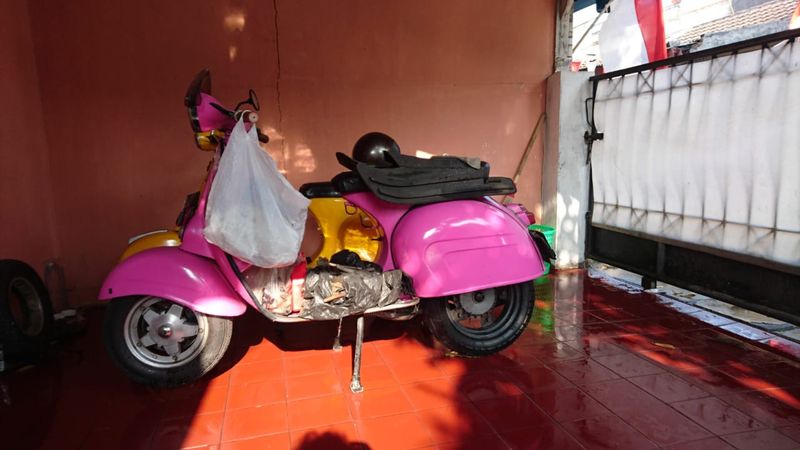

put the new 12' wide tyre and it look awesome

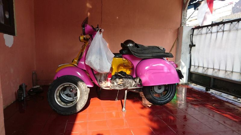

thanks Brother Pheas, now i have 2 problems, just change the front tyre with a bigger one and it also rub the shock despite all effort i done to put it in now i need to cut the rubber in the edge of front tyre a bit
still thinking of fabricate the front fender (someday) until then have a nice day and cheer
i know the tyre too tall, but thats all i found

in reality its quite funny if u ask me
That front tire made me laugh! But its really cool and looks awesome!
How does it ride?
look funny right Brother PP, i test it around the blocks and lots of folks from kids till adults asking me the same thing, thats a huge and how does it ride.. well i can only its the same as normal vespa as long u dont got puchture nor a flat tyre cause if u do imagine how heavy it will be with a wider rubber
V oodoo wrote:
Really, Ebeth? Are you serious or just having a little joke on us?
Where does the tire go if you hit a bump, eh? What have you got for travel, like maybe 3 centimeters? If this actually works well, I'll have to hand it to you - you are a scooterboy magician! Stance is killer regardless.
i am serious Brother T, u know we scooterist like to look diferent right, and its cheaper to do this since i didnt buy any new parts
and sorry i forget to tell you, about the travel in the front, i got almost zero movement i set the shock to its hardest stiffness so it can only bounce for 1,5 cm max even if with a passanger, imagine if i ride alone so its safe but i still need to test it on a long run first

this time i manage to fix the rubbing issue but still i need a bigger front fender and slimmer shock, guess i have to back using the smallie shock again
it rub here, so i have to cut a bit with sandpaper
i manage to set the shock to its final stiffness, since i already modified it with lots of oil before so no problem in the travel, but still the side as the spring is too wide
test it on a road bump around the house, bumpy yes but still not rub the fender for now
see how happy i am now

yesterday, after i test it on a long run i notice i need to reshape my engine position, cut my engine fan guard as its scrapping my right cowl, like i said its too tight and my engine seem to lean to the right a bit, gotta straight thing up.. after i reposition i now have a more spacius room between the rear shock and the tyre, its a big yay.. now left is the front, still unable to use the wider tyre.. but i got the idea just wait a bit longer
here's a pics of what i do, hope u all dont get bored
see the damage fan cover, goota cut 2 strip and it like a older fan cover
the engine hole is miss that much, almost half
jack it up and drill it
cut a bolt and weld it to cover the hole, so the engine will stay there firm

Fri Sep 13, 2019 4:28 pm quote
i nailed it..
finally i manage to put the wide tyre perfectly in the pink
i found a leaking honda tng rear shock for $1 less since i only need the spring as it have a smaller diameter then mine.. cut the shock tube to release the spring, cut the spring to make it lower and fit in my super low shock, test it on a run as in the first 60km, at first few km's it rub a bit but after that its a free like a whale
this mean i can stop working on the pink vespa for now, thats and until i found a nice used helmet to be cut for the windshield and maybe change the worn piston someday in the near future
until then have a nice weekend to you all and cheer
have to cut to get the spring out, i know i am barbarian
and yes make it lower since i am short
see the difference, now the spring wont hit the fender and wont rub the tyre
its only play 1cm so i am all good plus the top spring holder is smaller
i also make it longer half cm so its not 90 degree anymore
i am so so satisfied and happy
