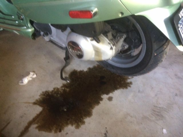

Just changed belt/rollers and rear tire. Started fine engine bogged and died, then I parked it in my garage.
15 Minutes later I saw this. (Oil is coming from top of case.)
Any Suggestions?

when was the last time you serviced the air filter?
Last week.

How's the oil level? Did you open up the airbox to look inside? Looks like it's dripping out from the air filter, but that's a lot of oil for that.
