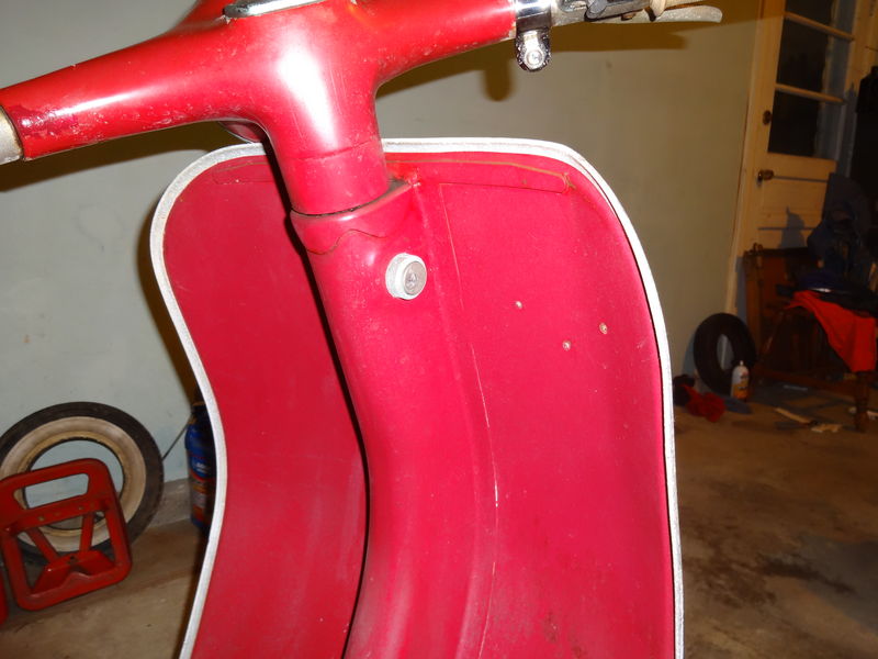

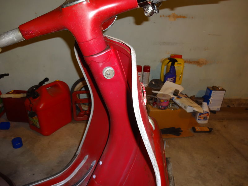

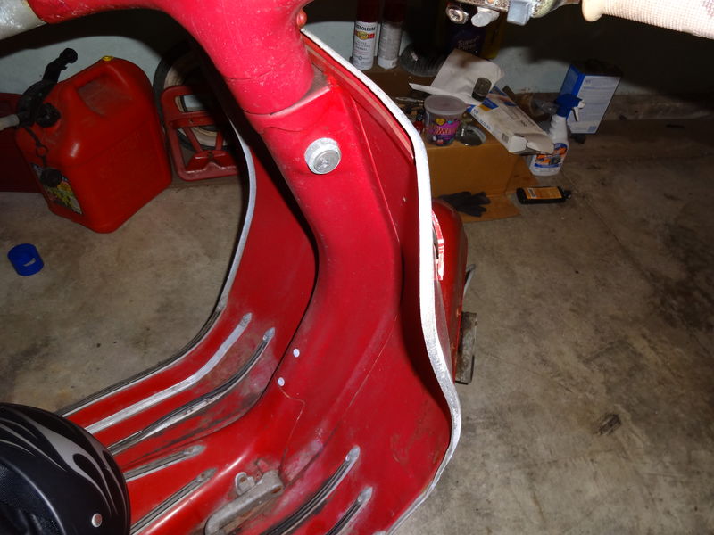

The upper right leg shield on my 1963 Allstate as been bent back for sometime (see photos). I have asked various body shops in the area if they can fix it but they usually do not want the job. My question is how can I bend this upper portion of the right leg shield back to its original position? Should I use a rubber mallet or is there some other method I could use to bend this back? I am afraid if I hit it with the rubber mallet it could damage the aluminum trim around the leg shield. Any comments or suggestions would be most apprenticed.

The use of a clamp with wood blocks worked great on returning my bent Allstate leg shield to its original position (see photos). Pressure by hand was applied to the clamp and the bend was removed. I did put a cloth rag under the wood blocks to prevent damage to the original paint. My thanks to all those who helped in this project and to my brother for the use of the clamp.
