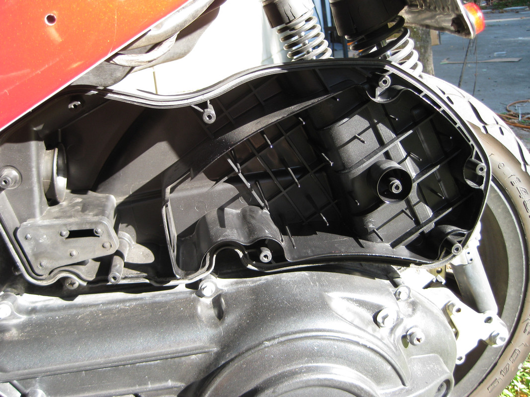

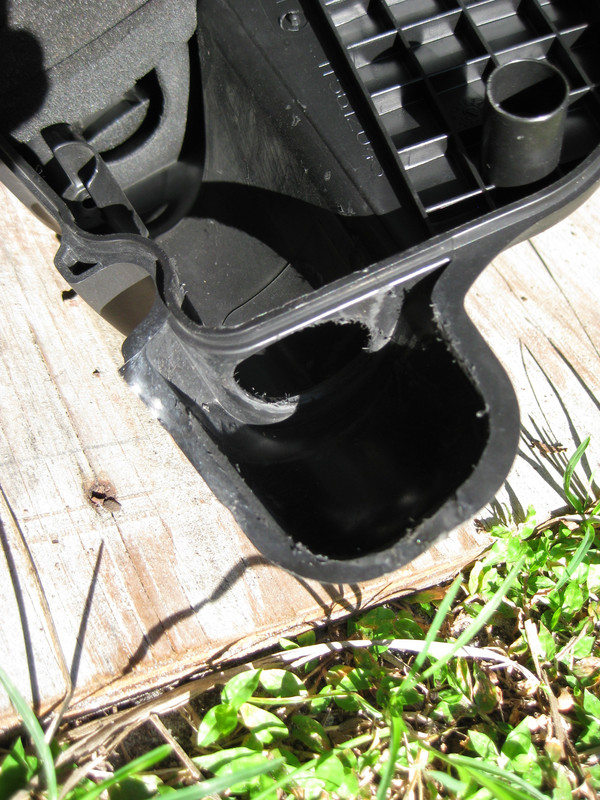

so I removed the tube from my box last year when installing new stock filter. I first got the bike. put 4000 miles on it since. a few days ago I checked filter and it looked like it was doing its job. trapping lots of debris. florida is very sandy. cleaned the box. but during cleaning I noticed I never bothered to port the inlet to the box. looking at the inlet tube to throttle body I said to myself thats got to be a restriction. sure enough. taking tube out is step one. but the inlet needs to be ported out. bike picked up quite a bit of zip. very happy .
fast forward to tonight I am reading unrelated thread and the airbox discussion came up. removing tube allows air to bypass straight to the engine. I am thinking to myself, "no it cant be" I have been running bike for a year unfiltered. couldnt wait till morning to see if this was true. so I go outside to open box again. here is what I found.

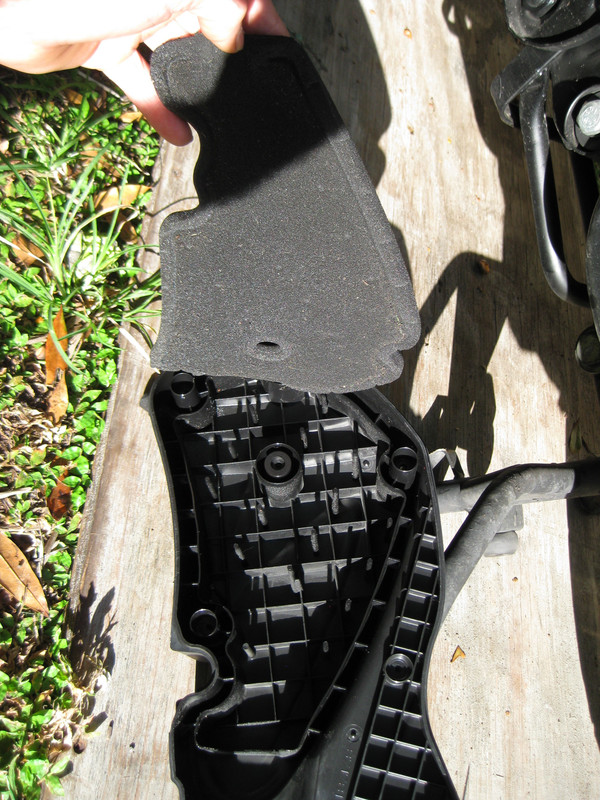

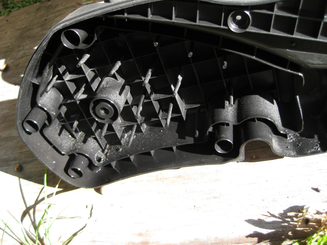

so it is true. but there is a saving grace to it. the air filter still functions quite well as an air filter. I didnt clean the filter a few days ago. Only cleaned out the debris inside. those debris are all on the dirty side of filter. as it turns out air has mass to it. doest make right hand turns unless forced to. so the air still does go in to the cleaning side of filter first. not gonna go backwards any easier its easiest path is through the filter. add to the fact there is a fresh mist of oil coming from breather that is added to filter side. add to that the inlet to engine is high up in the box. the result to me is yeah , nothing heavy is gonna make into the engine. the lighter very small mostly just organic material making its way into engine doesnt hurt anything. it just burns at 1800 degrees combustion temps. it is known that even alloy shards will burn and not hurt your rings or cylinder walls. so I am officially relieved so much to the point I dont think I am going to add a dividing panel.
three days of filtering on plastic parts. 3500 miles on filter. only lightly shaken to banish the loose debris then put back in.

Careful with that airbox mod, you need to block off part of the inlet to be sure all the incoming air is filtered.
I have had mine done now for ~4 seasons and ~22,000 miles.

I ended up tweaking more. made holes a little bigger that leads into the filter area. and added small flap that blocks the majority of path to other side of box. the space next to the flap is where the oil box is. and there is flat area there that straightens the path.

I do NOT recommend jerry's style of airbox mod. this will still let unfiltered air into the engine.
If someone wants to do an airfliter mod PLEASE do it the right way and make it like the ponydrvr mod.

I view Jerry's mod with suspicion. I can see several issues with it. Please don't follow that mod unless you want to encourage real problems with your engine.

just noting there are two bikes in tampa that are running prefect after 12,000 miles combined. we have been lucky all damaging engine particles are still magically being trapped by the filter. as evidenced by my own eyes.
for my own notes. the last tweaks I did slowed the bike back down. there is HP hidden in this box. better to get a pod filter if you can withstand the noise. I dont like noisy so I will keep tweaking till I get my cake and eat it to.
I test my mods against my friends beo 500. combined weights are within 10 pounds so the bikes perform extremely close. but he has always been just a tad faster. the simple mod that left a smile on my face resulted in me beating the beo for the first time. the final tweaks made the bike slower again. the beo runs malossi filter, me stock. so we switched filters. no wala. filter does zero.
then removed flap to see if power come back. it did not. so my research continue.
