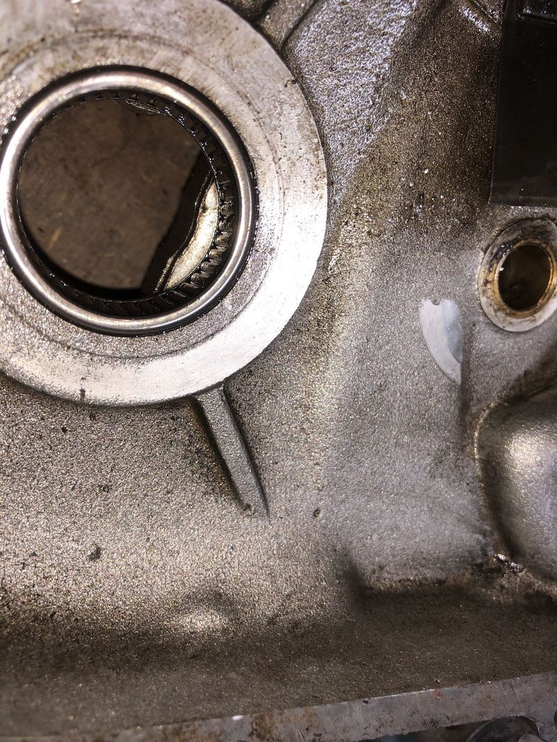

This looks hard to get out ad back in. Is it mandatory to replace it?
05 Stella, '62 VBB, 76 Sprint V, 63 GL
Joined: 16 Jun 2011
Posts: 2351
Location: Chicago. Well, Evanston, but that's almost Chicago
Fri Oct 18, 2019 11:25 am quote
The driveshaft bearing should definitely be replaced. Get a heat gun and use it to heat the case. It will fall out with a tiny bit of tapping, and the new one will pretty much fall back in.
A heat gun makes a HUGE difference in the ease of working on these motors.
I now know.. i used it today, works great!

Was able to get some work done today..
Managed to open the primary, put double springs in it and close it again more or less correctly.
Also managed to get the bearing of the rear axle in the case. And the engine mounts!
After that, I remove the tab in the case in order to be able to fit the large clutch.
Also discovered there were a few items of my order missing, amongst which the seals. So unable to continue the engine for the moment.
Also good news.. SC made an mistake and sent me a Vespone instead of a Magny Cours. So the engine config has changed a little in regards to the top end.

Are you sure that's not a Magny Cours? The base gasket looks different on a Vespone because they have bigger transfers where the cylinder meets the casing. My Magny Cours also came with the A3703 head (extra 4 bolts). For some reason, they still show the old head in the photos.
Well.. not anymore.
Not sure how to see the difference between the two...

those are some serious transfers, but it's nice because it looks like an easy bit of grinding to accommodate them. Are there issues of breaking through, or is there enough meat there to do it without issue?

When I ported my VBC cases (150 Super), there was enough meat for that Pinasco base gasket. The older small block cases are much better than the late ones in that regard. You just need to watch the profile/angle as you grind down into the case. You can see here in the first few photos of my build:
VBC1M (190 Super) engine build
My plans started with a Magny Cours in mind and so my case porting was based on the Pinasco base gasket, but I ended up using a BGM 177 kit, so I had to modify the cylinder to suit the ported cases.
To check which kit you actually have, the label on the packaging should have the Pinasco product number. Just check this against Pinasco's catalog on their website (should be 25031941) or check out this link to SIP:
https://www.sip-scootershop.com/en/products/racing+cylinder+pinasco+magny_84119100
The Magny Cours is a good choice for your engine as it is the pre-P series style, which some say is weaker in certain areas, like the narrow taper crankshaft for example. Best not to go crazy with the horsepower.
I am not going to do any grinding. It’ll be fast enough plug&play.
I looked into this, and it appears that they now send the magny cours with the same cilinder head. Besides the gasket, I have no idea what the differences are between both kits...
So: it’s a Magny Cours again!
