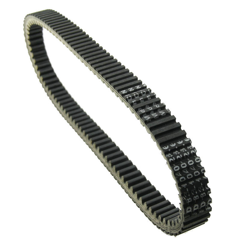

Has anyone had any experienced with this. https://www.aliexpress.com/item/32896410321.html?spm=a2g0s.9042311.0.0.299b4c4dIicoQM

my china belt came in. but I think it is too small to try? will this belt even fit? wouldnt it be rubbing on crankshaft at idle? would it force it into lower gear sooner? I did checking and the belts range in length from 1036-1044. this one is only 1001.
Joined: 26 Aug 2007
Posts: 38926
Mon Dec 23, 2019 9:08 am quote
Far too small.

Thanks guys. there is a china belt that is 1040 in length. thats the one I should have received. interested to see what seller says.
so with more research there was a shorter belt for the atlantic 500. 2001-2004.
there are two belts for those years. chassis PT00 VH00
827826 27.7 x 1011
832738 28 x 1036
found some info from italy that suggests 2001-2002 uses the shorter belt. curious exactly what changes in the variator? chassis number didnt change
in short though anyone who orders belt for their 400-500 from asia needs to be sure they are getting the 1040 belt and not the 1001.

seller stepped up and sent the correct size. which is crazy to me. he had the 1040 size listed for 50 shipped. seems he should have just refunded the 23 I paid. wonder what these really cost over there?

so I got bored today and put this too short belt on the bike. it indeed fits just fine. bike drives just fine with it. even did speed tests against my buddies beo 500 and there were tiny losses in power due to the different gear ratio created. and I mean tiny. the only problem I found was belt was a bit noisy at idle. but I think its due to belt running deeper into rear pulley. I am running the malossi white spring on the clutch pulley so more pressure on the belt. I didnt care to try going back to stock spring. will post pics later on how deep it fit in back pulley.
but zero slip! and bike drove great with the belt.

so the longer "beefy" belt arrived. it has been on the bike for about 200 miles.
the current piaggio belts are 1036 x 27. this china belt is 1040 x 28.7. the third dimension is contact width, piaggio is about 14mm. this china belt is 16mm.
initial impressions
above 3000 rpm. fabulous. transmits all the power with no feel of slipping
below 3000 rpm. unfortunately not great. the belt does not flex as easy as piaggio belt. so there is more vibration felt. and again I wonder if I should try going back to stock torsion spring.

so I couldnt stand riding the bike after the first tankful on the big china belt (1040 x 28.7). just too much vibration added to the low speed operation. yesterday I reinstalled my used belt that was 26.6 thick. I removed some fuzzy washer thickness to compensate for the wear.
I officially suggest no one try these china belts. They dont work well. not worth the savings at all.
I would also be reluctant to try the mallosi belt for the 500 as well. It is very large belt at 1044 x 28.7. I would be afraid it would vibrate as well.
The bike is FAR more fun on the small belt. Not just smoother, but the power hits quicker on the small belt. bike is just more responsive.
above pic is 1001 x 26.9 belt. below is 1040 x 28.7
big china next to OEM 832738
