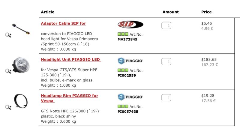

I bought all the stuff to retrofit the 2020 HPE LED headlight on my 2018 GTS and it just doesnít work. After installing the headlight, I canít make the headlamp rim work on it.
What am I missing, hereís the parts list.

The page you posted states that the parts will fit a GTS from 2019 onward. Since your model is older, it doesnít fit. Looks like the headlamp is not a model made to retrofit a pre-2019 GTS, but is a spare part for the hpe versions.

Yep and these are supposed to be the parts.

Okay, that isn't the LED headlight made to work with older GTS models.
This one is:
https://www.scooterwest.com/headlight-assembly-250-300-super-641081.html
And here's the video with Robot explaining it all for you (along with a cheaper option):

the LED headlight unit with the cast aluminum body that fits in the old GTS is not a Piaggio part. I have seen them, and they seem to be fairly well made, but I don't know if they are DOT approved or not. There seems to be one or two companies making them, and they are popping up for sale everywhere.
The OEM headlight assembly for the HPE does fit in the non HPE GTS, but you need to make some modifications to make it fit and work. It's not plug and play, but it's fairly simple. I've got one installed in my GT 200, but it took someone else coming over and looking the assembly over to figure out how to make it fit without destroying the bottom of the speedometer. .
