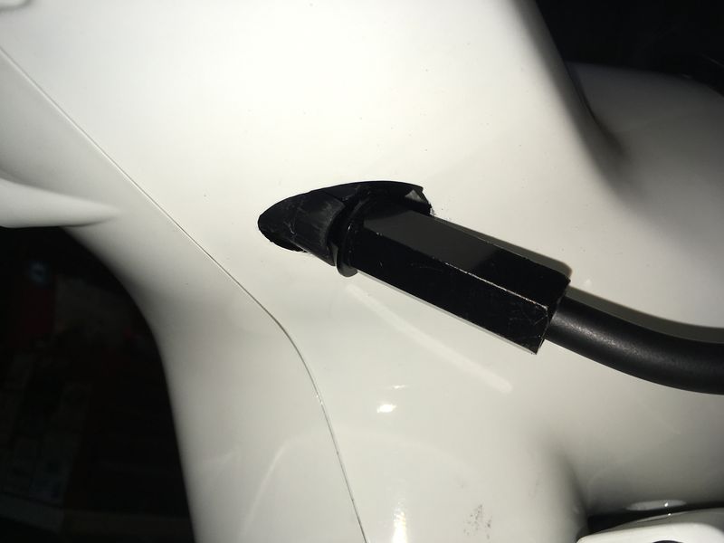

This attachment hardware sucks, the plastic collar deforms before the piece is tight in the headset, and eventually cracks.

So, Iím wondering how I failed? The instructions Iíve seen on the internet make it appear easy. I am wondering if this is a fake one, the mounting hardware on the scooter west video and part listing page looks way better than what Iíve got.

I can't see clearly enough from your photos why it should not fit.
I found on my Vespa flyscreen that the top screen mounting bolts had to be right at the top end of the mounting bars to fit well. I notice yours is still some distance from the end...?

Yeah if I moved it up that far then the bottom edge of the screen would end up on the bar itself and the bottom fasteners would be pulling in against the curve of the screen. See how tightening the bottom with it adjusted that way will cause it to crack?

I see your point - I found a similar limiting situation mounting a mid-screen onto touring screen bars to create an air channel between the lower edge of the screen and the headlamp.
Perhaps the mounting bars are not OEM or are incorrectly bent?
I do find the fit quality of Vespa accessories to be lower than my BMW bike stuff.
Those expanding plastic collars should still work the other way around.

I'm with you - the shape of these bars and of this windshield are not compatible.

Ha, figured it out. It's a crappy fake from China. Made by a company called Heinmo. This is why it sucks and doesn't fit.

I see now the following about the original windscreen that failed:
-the screen itself was the issue. the hardware is pretty close to the vespa hardware, which needed to be fully seated to have a firm grip. since the screen would not allow me to fully seat the hardware, it was definitely mis-manufactured.
-they did a decent job copying the vespa screen mounting hardware - the shape and bend looked reasonably close, and the pieces were of the same type / design, so much so that I'll keep them as spares
so in summary, don't buy cheap crap from ebay, especially heinmo screens . wish I'd have known that was what i was buying, but the seller did actually copy the e-bay ad into his ad, so that's at least partially on me.
