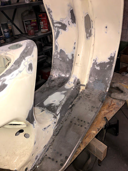

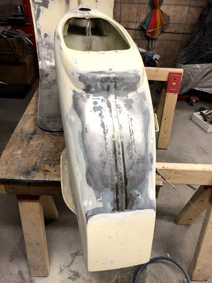

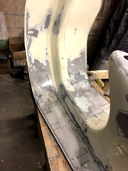

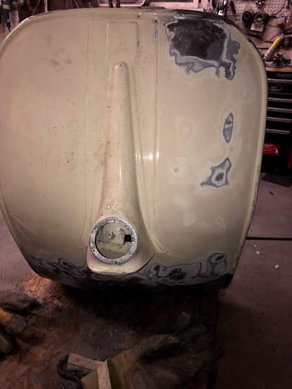

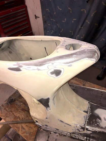

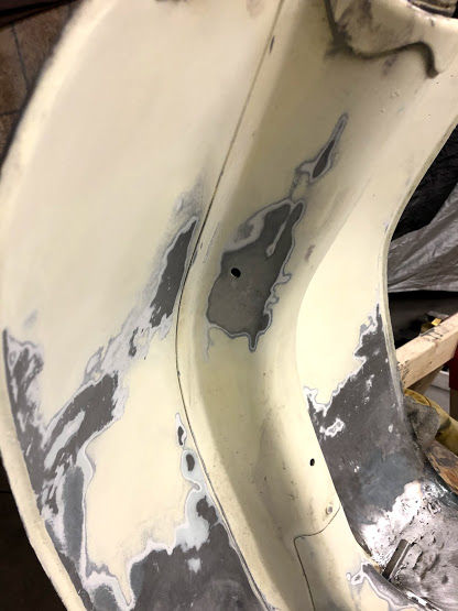

Hey guys just wanted to show where I'm at . Started sanding down the frame, I'd start on a small spot to feather out and next think I knew I'm joining the bare spots. Am I out of control ???
Should I keep going removing all the painted area or what, PS I'm definately no body guy and have a whole new level of respect for you's that know the ins and outs.

Iíd recommend getting the frame chemically stripped (acid dip then phosphate coat). Comes back look like like my bike - I liked the phosphate look so much I have worked to keep it as is.
This method will remove all paint and rust from the frame (like inside the tunnel and all those seams too) - places sand blasting or by hand can never reach. The phosphate coat acts to stop rust - it just isnít very durable (which is a shame) so just buys you time before painting.
Should be very cheap to get this done - I paid <$200 USD for my frame, cowls x3, glove box, and headset for reference (in NZ tho).

If it were me as far as youíve gotten already....I would totally strip it. I would have someone strip it. Not that expensive, unless your time means nothing. Just my 2 cents.

Ok hereís the thing, if it were a Monday I would drop it off somewhere to get it blasted,but seeing as itís Friday and Iím now off until Wednesday, I have lots of time.
I wish I would have listened when someone suggested getting it stripped as while back, I was looking at it the wrong way back then, I was thinking why strip it when I know the frame is not hiding anything under the paint, duh my bad.
Ok so I will ask what would be the benefit to keep on going with the da sander with the 80 grit paper compared feathering away?
Would the 80 grit be too course on the painted surface to apply primer?
Iíd really like to move forward with some bondo if possible.
buy a cheapo stripper from harbor freight and blast it yourself

Thereís no reason to strip the whole bike to bare metal. In places where the paint is in decent shape it can just be scuffed, primered and repainted.
What youíve done so far looks fine. You may want to use a filler primer to get a nice level surface for your basecoat.
Yes, 80 grit is too course to be covered with primer and too course for feathering. Itís for rough shaping. Scratches will show through. I use 240-400 under primer, but read the TDS for whatever primer youíre using. Itíll tell you what grit to use.

If you donít strip it...then you have to make sure that you feather edge the sanding so the silhouettes donít show through. Even if you use a filler primer they can still show through. For me it would be easier to strip it and donít worry about the silhouettes. My thoughts....

Are you using the same paint that you had put on before? When you ALREADY had it blasted and primed with what I assume is good stuff? It's really up to you and how "perfect" it has to be, and how well you do it this time. If it was mine and all the white still there is nice, I'd do exactly as SoCal Guy says, and look for "hi build" primer as noted, just keep it to the bare metal and mostly off the white. Final fine sand the whole thing, use your tack rag all over, screw up your courage and shoot it, right?
Looks to me like that happy new DA sander you got sure works awfully good.

Yes quite a bit of the paint is in very good shape, I'm simply having a hard time with the feathering, there seems to be quite a few very very small paint chips and when I sand them out I end up with larger than desired area and it then only makes scence to open the area right up to metal. I've attached the filler I bought , its suppose to be a very good shop grade 2k primer.
Perhaps that is why I'm haveing a hard time with the feathering because of the 80 grit on the Da Sander. If I goto the 240 first then to 400 can I use the Da Sander or is it better I don't and just use my rubber block sander?
For some reason when I tried some 240 dry sanding on the painted area it felt kind of rubbery like the surface had a protective layer, I realize wet sanding the painted surface to scuff up would be ideal but I don't want to get the bare metal area close to it wet.
Would I be better off scuffing the paint with wet sanding and then doing a 2k primer on the entire frame including the bare metal and good scuffed painted area and then come back and do my body filler work?
Sorry for all the questions.
Edit : I looked up the instructions for the primer... Crap as you can see it says to Metal areas
should be sprayed with etch primer prior to priming. Is this necessary , do I now have to go spend another $100 on etch primer??? I told the paint guy at the Napa place exactly what I was doing and he said this primer is all I need.

Your paint guy gave you the wrong stuff. That primerís not for bare metal. Itíll work but itís not going to last.
Use an EPOXY primer on the metal and the scuffed paint. Epoxy has excellent corrosion protection and is a great sealer. If Montana is the brand youíre using, see if the shop has this:
https://www.chemspecpaint.com/brands/montana/undercoat/surfacer-sealer/ps3042-epoxy-primer-light-gray-g-q
You can use the other stuff over the epoxy.
As for sanding, I do most of it by hand because there are so many curves and angles on scoots. The thin rubber block sanders are what I prefer.
