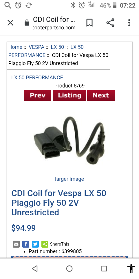

I always recommend replacing the fuel lines with translucent fuel line readily available from your local power equipment dealer. Mine has a blueish tint, and is ethanol resistant. It makes it really easy to confirm the fuel line is full of fuel, and the vacuum line isn't. Maybe your carb just needs a good cleaning. It's a simple carb. With some mechanical skill it's an easy job to disassemble, clean and reassemble. If you're not comfortable with this, just replace the carb.
There's always a chance the fall may just be coincidence, and you may have a faulty CDI. If you have a 2005-2006 LX 50 I highly recommend replacing the CDI. If it hasn't failed yet, it's only a matter of time. Also, if you haven't already, replace the spark plug at the same time.
Click on the link below and read the entire description.
https://scooterpartsco.com/vespa/lx-50/lx-50-performance/cdi-coil-for-vespa-lx-50-piaggio-fly-50-2v-unrestricted?zenid=42f81476ba682601277d05c62474309c
