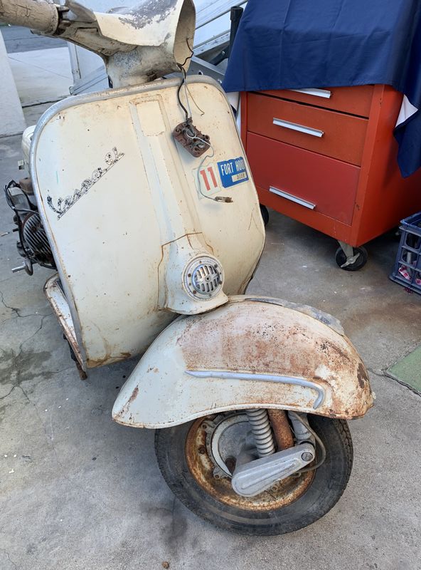

Strip it, Cut it, patch it and your good to go
You make it sound easy. I get the basic concept ... cut out the rot and replace it with good metal. Like a big ol root canal. Making it happen is a different story. Guess I'll know better after it's stripped.
uh oh... goes thru

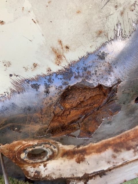

I learned a lot about the inerds of these frames when I replaced my floor, the fabrication work youíre going to have to do may be better accessed and completed working from in the tunnel outward. Iím actually surprised the floor isnít in bad shape as well.
2:6
Joined: 11 Jan 2007
Posts: 7507
Fri Feb 14, 2020 5:47 pm quote

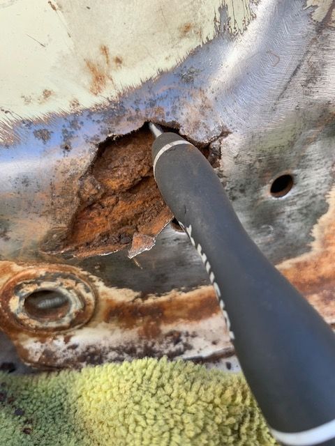

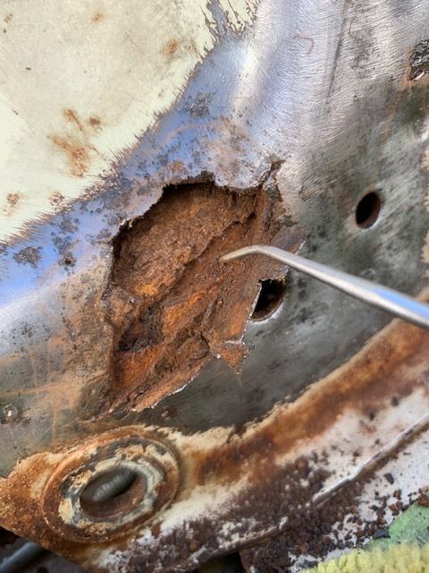

I think that section is 3 layers thick with the tunnel, the outside of the body, and the inside that forms the fender all stacked up. I would think that a proper patch would be to each of those layers with the seams being offset.
getting all the rust out first, then enlarging the hole in some layers to allow access to the others.
Joined: 26 Jan 2019
Posts: 871
Location: california
Fri Feb 14, 2020 10:52 pm quote
Patrick's insight on layers being there is a good one.
My $.02
I would Dremel a hole larger so that its cut back enough that you
1. have no rust
2. have a reasonable oval shaped hole that you will be able to trace with your welding gun.
(The layers don't need to be feathered with this method - the weld will bite in to all of them from the side).
Cut a thicker (1.6mm min. 2mm better) patch larger then the hole - that underlaps it - and put it on in the back side.
Tack it in around the perimeter at 4 corners.
Then put a slightly smaller patch on the front - a second layer.
Before you install it - drill 1/4 holes in a 5 pattern - these will be filled with weld as spot weld. (see illustration below).
This second layer will sit flush with the body work.
It should be just smaller then the original hole - so that there is a valley between the second patch and the scooter body.
Take this second patch in place at 4 spots.
Now just spot weld in a circle using the stitch method. Spot right in the valley by holding the gun perpendicular to your work and simply rocking it back and forth so it hits the scooter body, the valley, and the top patch.
Pick up the gun, move it an inch, do it again. Keep circling using the rocking method until you have "stitched" all the welds together.
Spot weld the holes in a 5 pattern you drilled, in the same manner. this will tie the middle of the patches together. Then get out your grinder with a flap disc on it and do your thing.
Oh - and do this to make the welding part go well.
- lay the scooter on its side so that area you are working on is level.
- Use a thick piece for your backer (1.6mm or more) because it will soak up heat. START your tack weld on the patch (in the valley) and rock your gun back and forth on to the body and your flush second patch. The heat will stay on your thicker patch which can take it without such easy burn through.
People who actually know what to do can now tell you why you shouldn't do any of what I just said - but it is executable - and will eave the area stronger then it was from the factory.
I await my welding banishment.
-CM

Here's my whole though on rusty frame repair...if it's a common scooter frame (such as a P series) that has lots of rust, you'll be spending probably close to $300 once you get it all removed and then patched back up. That includes getting the frame media blasted, cutting out all the rotted metal, then dipping the frame in acid, and then patching panels back in..and that's if you do all the metal work. But that's if you only want to remove all the rust. Some folks are fine with a more bare minimum, and are fine with leaving lots of rust in the frame. A nicely used P or Stella frame should only cost $200 to $300 max. You will ALWAYS be time, trouble, and money ahead if you just find a different frame! All that goes out the window if you have a rare scooter though. I had to repair a fair amount of rust on a T5 that i bought. Since it was a Mark 1 square tail, the frame was worth saving. First i media blasted it. Then i sectioned out all the rusty areas (same place as yours, which meant 3 layers of monkey business sheet metal), then got it acid dipped, then i sectioned in new patch panels. When i was done with it, it had zero rust.
So my though is, that if you spend only $100 on fixing that frame, you have spent $100 too much. That $100 could have been put towards a frame that's in excellent condition for only another couple hundred. I'd search out a Stella frame at a replacement. Option B, is search out a smashed Stella, and section pieces out of it to replace your rusted out spots. It will be much easier than fabbing up your own contoured panels. And currently you can only see just some of the rust. Once you start pealing away all those layers of sheetmetal, it's going to get a whole lot worse under there.
If you want something to last, you have to put in the time to make it last. (same thing for engine builds). Don't skip...unless you want to go full ghetto on a super rusty frame, then you could literally just weld in some 2''x2'' angle iron to span that length of the tunnel. I'd be more inclined to make some sort of "yard art" out of the frame instead.

I had a wee bit of that rust on the Sprint in the same area because there is a pit inside the frame where bad things go to and don't leave. Anywho, during and after the media blast, I took a good look at it and it was not in bad shape. I followed up with pouring some Ospho down in the hole from the inside and let it sit for a day. Some of the Ospho leaked out, but no matter, I sucked out the rest, let it dry and followed up with pouring molten lead in the pocket. Again some leaked out, but I was able to shape it with a file and sandpaper. Your will obviously take more work, but it will be totally worth it. You got this - good luck.

Great input from the Think Tank. Well-considered and thoughtful responses across the board, much appreciated.
First off, in my estimation the area is completely fixable ... and it will be fixed. This is nothing compared to what Iíve seen on other projects.
whodats: Likelihood of me ditching this frame = 0. If it was a P, maybe. Not gonna spend a fortune on blasting and prep, and not trying to make a museum piece either. But this oneís worth saving.
oopsclunkthud: Correct as usual. The rot is near the intersection of three sections of sheet metal. The worst of it is at the end of the drip tray where it curves down toward the floorboard. Not the easiet place to access, but as far as I can tell, not structurally critical.
charlieman: The detailed diagram and instructions are brilliant. Pretty much the approach Iíll take, with some modifications. Access is going to be the biggest issue. Welding anything from behind in that area may not happen. The curve of the metal will also be a challenge, but Iím up for it.
Lynn: You havenít seen stubborn yet.
GeekLion: Thanks for the offer. After I get the area cleaned up Iíll let you know.

The two overlapping skins are a great rust hidey hole... I guess what I'm saying is the visible tear is where the metal is down to nothing, how thick is it 1" away? There's a bunch of repair sections available which would make it easier to decide to replace a larger section.
https://www.sip-scootershop.com/en/products/repair+sheet+tunnel+for+vespa+_pv1539
1979 P150X, 1983 P200E, 1987 T5, 1996 PX200E, 2011 Yamaha Fazer 600 S2
Joined: 02 Aug 2015
Posts: 1761
Sun Feb 16, 2020 2:07 pm quote
Personally, I would open it up more than that. That's not rust, it's rot and continues to spread like cancer. You have to stop it as much as you can. On my P what started as a small surface rotten section, revealed underlying rot that was bigger. I cleaned it to the point where there was no rot anymore, applied a rust stabilizer gel and welded a new piece of sheet metal which was treated with the same gel and sprayed with primer from the inside. Then on the welds and seams I applied solder instead using bondo...

Safis that is a nice repair job. SoCalGuy would need some very solid metal on the inner to plug weld to. Excellent.

Agree top job on Brother Safis and yes its not rust its a cancer on a metal frame

whodats, all good. I donít think anyone suggested just pouring Ospho over the holes and calling it done. Thatís not how I intend to deal with it anyway. Most people here know rust needs to be hunted down and removed. Thatís why I asked how experienced people deal with this kind of rot.
I normally shop out all my welding. Would be easy enough to send this out too, but that would be a zero learning experience, wouldnít it? These projects are as much about the process as the final product. Others may feel differently, which is fine. Yes, I could trash the whole frame, chop it up, put a P engine in it ... would be fun but a completely different project.
Appreciate the feedback everyone. I think I have a plan of attack. Fabbing a patch with the contours of the engine bay will take some finesse, but itís doable.
