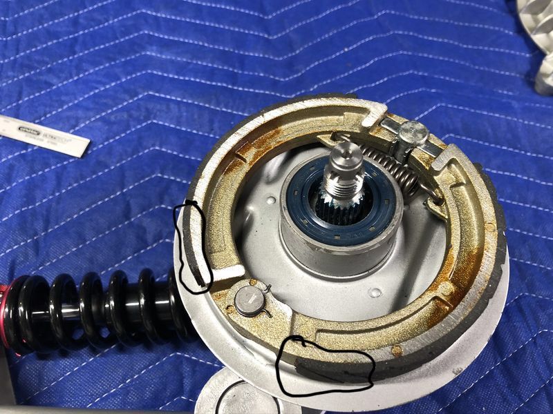

The new Newfren shoes come with tapered leading and trailing edges. I had to dress the ones on the 64 with a file to taper the square edges.
