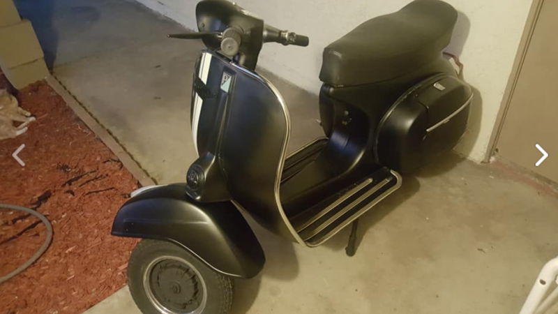

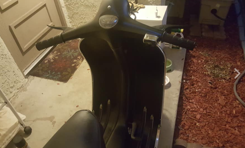

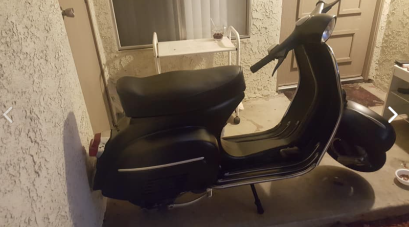

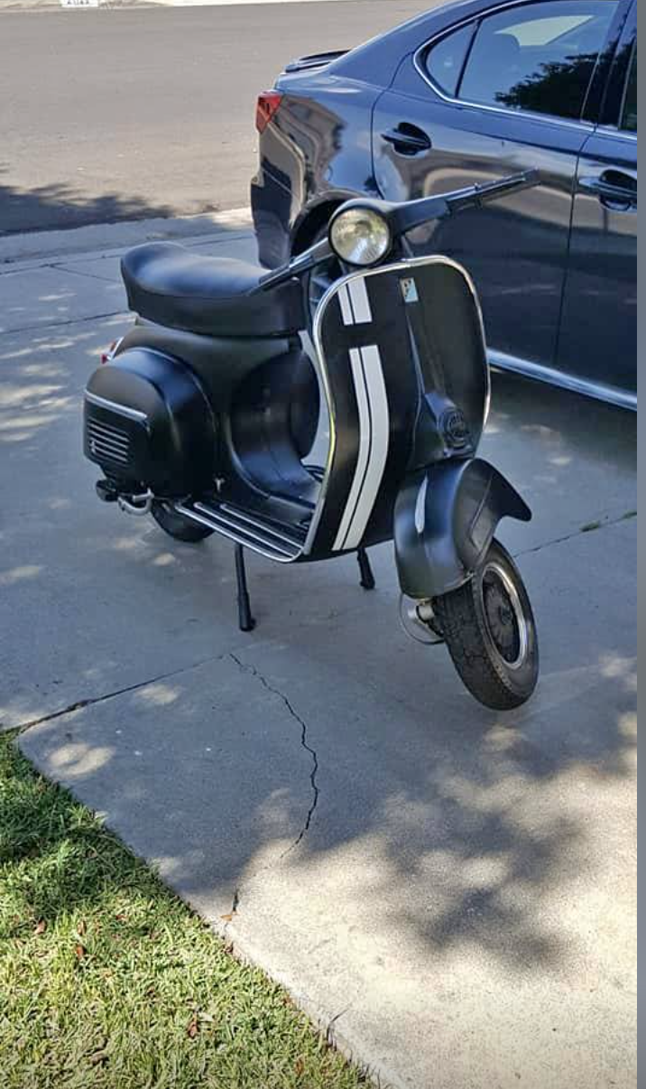

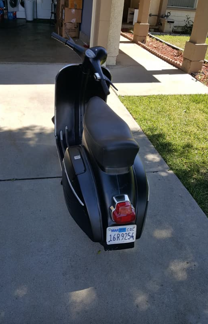

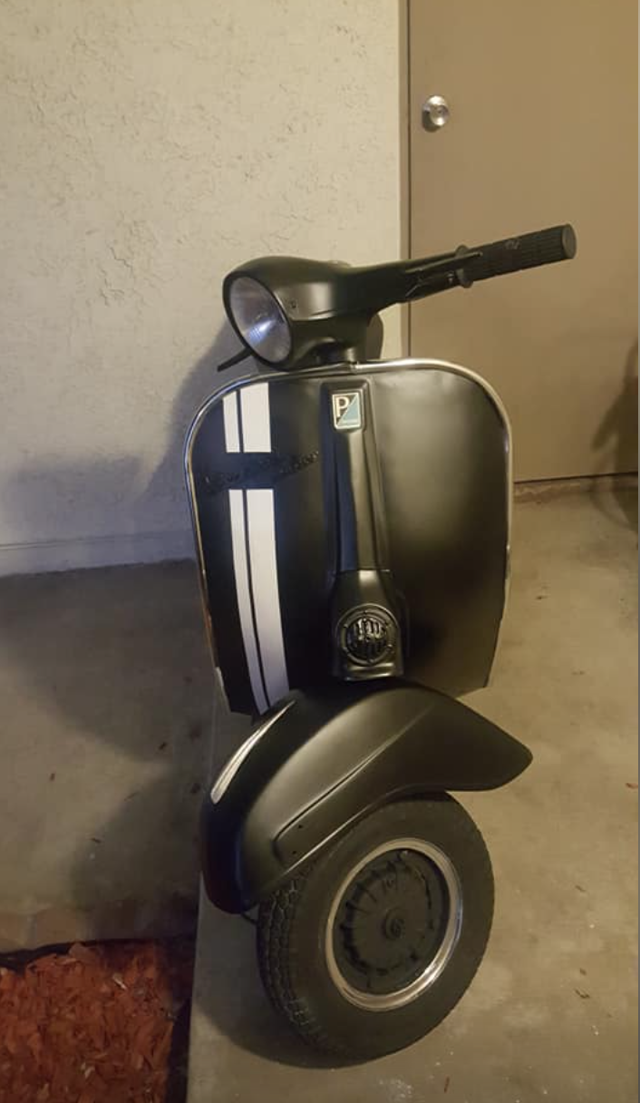

Hi,
Does this scoot look solid or bodge? It's not very close by so i'd appreciate any feedback. I did post in General but it was suggested to post here. Thanks in advance.

Just on quick glance, leg shield at the top along the trim looks suspect. Shouldn't be wavy like that. Hard to tell from the photos but I'd get real close and look in all the hard to reach areas to see if they are hiding issues under flat black paint. I'll defer to others with more experience if things are incorrect for the model.

Ameribodged Super still on 8" tires, so if the price is OK, there's no cancer and the motor isn't trashed, go buy it if the papers are in order. I did the same thing but mine was spray bombed yellow instead, which is currently being removed here Unpainting a scooter Same bike slightly older coz this one has rectangular badge on leggy top.
Crappy 2 piece aftermarket leggy trim can be replaced with a little effort to look like this bike with original style trim now installed right (jump to the last page if you like) 62 Allstate Cruisaire - getting it back on the road

Yeah, I think Voodoo's right... it's a 60's Super "resto mod". Still on 8's which is good. Prior owner probably tried to spruce it up and make it cooler with satin black paint, murdered out horn, stand, levers, hubs, badge, stripe, etc... I kinda like it.
Missing center mat, funky leg shield trim, repop floor rails missing some rubber, repop seat, grips and mud guard are from a later model, speedo looks like a repop. Some ripples under the paint. Nothing major.
How's it run?

The front fender lip looks a bit beat up also.

Put a fork in it, it's done. Just go inspect and buy it if mostly:
1 Massimo blesses the motor
2 the guy will do 1500 (optional)
3 the paint was done carefully and still sticks well everywhere
4 you sorta approve of the color( I kinda do)
5 you'd rather ride this Spring w/ minor tinkering on a "stockish"? bike
6 you aren't looking for a long winded and expensive restoration project.
7 papers are in order (again, optional depending on...)
This front fender is on an older Vespa and that is perfectly normal, wanna see mine?
You done good with the detailed pics!

i'd second on Voodoo. ask massimo what all was done and then formulate your decision from there. if it was a mechanical rebuild (including the motor) 2K is pretty fair. if it was just a fluff & fold/get it running kinda deal, then i'd offer less than asking.
the color doesn't bother me in so much as you can't really hide a multitude of sins under that. i'd be more concerned with provenance and paperwork (i.e. tags, title, back fees).
if, as i suspect, it's american market you'd do well to snap it up-- even at asking price. early script badge supers don't come up often.
from there, the sky's the limit. you wanna upgrade motor or suspension it's all doable. or, like V said, you can just cruise all spring and summer and decide on what you wanna do next winter.
