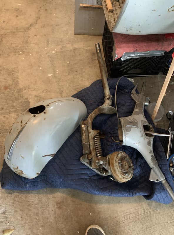

And in the perfect timing department... right after I finally got the fender done the delivery man showed up with a nice cowl from our new member Carlos (putting together a 62 Allstate). Thanks man!!!
1963 VBB2T
Joined: 07 Nov 2012
Posts: 1788
Sat Mar 14, 2020 5:20 pm quote
Looks good and paint matches too.

Almost... Sorry bad phone pic.... Cowl is a faded allstate blue and the scoot is Amethyst Grey.

Sent him my front end to get powder coated and his Pinasco treatment.
Stoked with how it turned out...

Tue Apr 21, 2020 12:16 am quote
what is the "pinasco treatment" you are referring to please?
P200 PX150
Joined: 28 May 2008
Posts: 4266
Tue Apr 21, 2020 4:40 am quote
The hub and shock are Pinasco upgrades.

Tue Apr 21, 2020 6:54 am quote
that's pretty cool, do you think Gick could do that for an allstate fork? nice looking setup.
