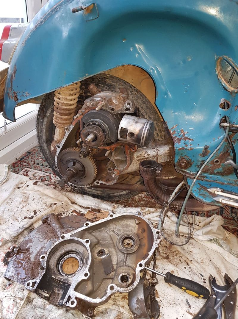

Hi everyone ,got myself a 1971 Motovespa 160 untouched, it needs a new quadrant , time on my hands thought i,d do it, took off the flywheel ,took off the stator/magneto undid all the fasteners .the casing has split a bit but wont come apart, had some advice of a mate saying the kickstart had to be compressed, so i had to drill a hole in the shaft and put a bar in because my molegrips were,nt getting a good grip ,the kickstart is depressed but the engine casing still not coming apart any advice please would be gratefully received, with time on my hands i think i,ll take out the engine but i,m unsure where to go from there

to split those casings, you need to heat around where the bearing sits with a blowtorch or similar the you can remove the crankcase half
the engine is similar to dismantle like a 150 super in that respect.The bearings are seated on the crank first. THEN offered up to warmed casings before being tightened to spec.
to paraphrase the haynes manual
disasembly is the same as assembly
good luck

Glad you managed to get the engine apart without too much drama - for most parts that are unobtainium as original spec, there are aftermarket/performance parts that can be made to fit and do the job. particularly in the carburettor area.
the engine is broadly speaking a GS motor - so be prepared for a shock on the price of parts

O.P. check the condition of the sealing pad under where the crank webs meet the inlet, hopefullly you will be ok

YES - it is repairable as long as you ensure that the groove is consistent around the entirety - elsewise you will not be able to insert the rubber O ring to seal the kickstart quadrant into casing and you will forever be dripping oil like and old british bike.
so ideally - build up with weld and machine the groove back in.
should you find this is not possible, you will be on the lookout for a replacemtn pair of matched cases. some people have been lucky in making none matched cases seal around the base of the cylinder but that is INCREDIBLY rare

The OP's motor look like a rotary to me. I read somewhere that some Spanish 160s were simply overbored Sprint 150 engines. Did I dream that? If so, I'll get my coat (as we say in the UK).

I'm firmly of the opinion that that scooter has had a replacement engine at some point in its life - which is no bad thing to be honest!
grab the engine or both and make a good one out of them all and away you go.

would i be able to gain any information from the engine number ?

put in the engine number

well blow me sideways!
Thats one of the 150 Super engines overbored.... should have no problems finding parts for that one and any of the Super/sprint cases will do nicely
