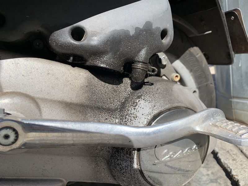

Hi,
Wondering if anyone can help me figure out what's going on here. Noticed this on my LX 150 today. And I'm woefully inept when it come to mechanics/maintainence.
Thanks!

oil drain bubble for your air box. if you dropped your bike recently then you should drain it and also clean your air filter. if you haven't had a service i awhile then you need one. if it just started looking like this, then you may have bigger problems.

Looks like you are blowing oil out of your air filter box. Have you recently changed your oil or added oil so your crankcase could be overfilled? Have you done a recent trip with extended riding at WOT? As greasy commented, possible options get worse from there. I'd start by emptying the excess oil bubble, cleaning the filter box, and cleaning the air filter. Also check your oil level. Then see if the problem reoccurs.

Too much oil or the wrong oil?

Just a hint, when installing the bubble, make sure the ears on the clamp ring face to the rear. If they stick out, sometimes your pant leg will hook it and pop the bubble right off.

Tip: When you pull that air filter cover off, put a rag under it to catch any pooled oil in the cover from making more of a dirty mess than you have now. I'd probably clean up the transmission cover before doing anything.

Popping open (er, unscrewing) the air filter box isn't a big challenge....you'd said you weren't too mechanically adept, but this is starter level stuff....
