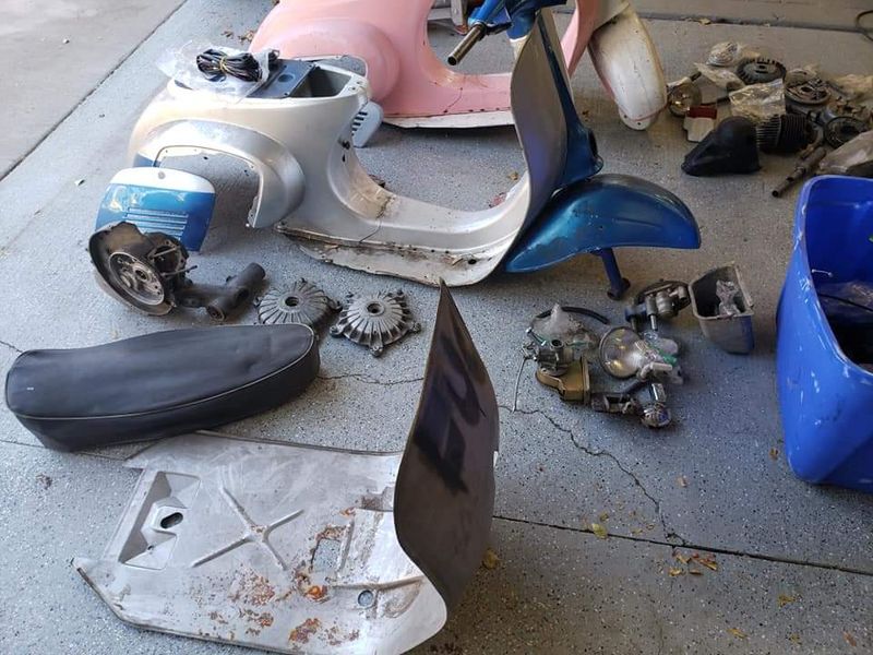

The real question is, whatís with that pink Smallframe thatís in the background?
Lol. pink smallie scooter club! I can't wait till I can join that club!

Q - is the list you posted for the engine we see in the picture?
If it is that parts list is not for that engine and you will be sending it back
and i would get something like this - until you go reed
https://www.sip-scootershop.com/en/products/flowed+racing+crankshaft+serie_45013000
also : we need another pink scooter one on here is not enough

Parts list
The photo is of my next project....
The pink smallie is now owned by another member on this forum.
I think there can only be one pink smallie.
The parts are going on a p200 motor for the cutdown project

To those interested - That Pink Smallie is in my stable, patiently waiting for attention at some point in the future. its a '64 90, just needs a motor; and the time and budget to build it. I'm open to input; but lets not thread jack
