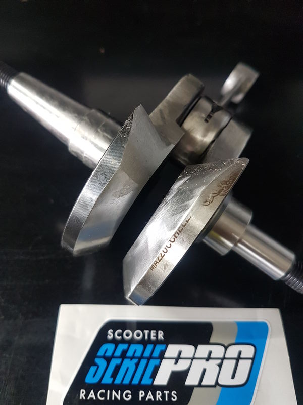

Starting a new build on VROne cases and some tasty parts are starting to roll in
This is the worb5 laser welded version 60mm crank

Niiice... watching this one with interest. Would love to know what difference it makes too (for those who dont know, Jimscoot already runs a MHR on Piaggio cases). Maybe - Tips on using GSF Dyno

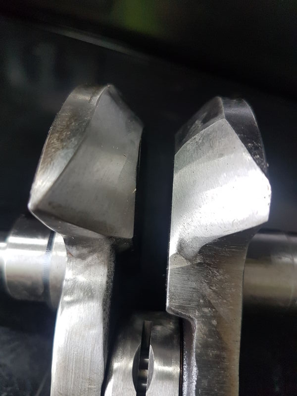

That's one fancy looking crank! The weld that's been sanded down looks suspiciously like either a TIG or even a MIG bead for some reason?

Jimscoot - that is one fancy crank.
Like it!
Assume this is going to be a reed set up then?
Will enjoy the ride.
-CM

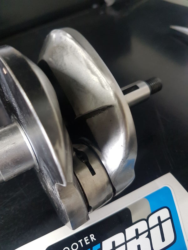

Yes itís already a reed valved motor on PIAGGIO cases as Ginch stated.
Itís just giving me more scope on the Vrone cases. Bigger inlet better flowing through the overflows etc.
Malossi state that you can use full web crank (full circle) as they have moved the inlet slightly more forward as to not block the intake or disturb the gases.
Does anyone have experience with the differences a full circle crank (high primary compression) versus a flowed or bell crank (Low primary compression) the variables and how it effects jetting etc.

There always seemed to be a bit of discussion on Scooterotica on hpc vs lpc.
You would gain extra case volume with the Malossi case, just because of that bigger opening and space forward of the crank as you described. So maybe with a full circle you'd have a similar case compression to what you have now? You can also increase with reed spacers and boost bottles. Not really sure of the felt effect of high vs low.

That crank looks looks the part! Jimscoot. Is that the one Sip call the evo flowed crankshaft? Iím trying to work out if the standard flowed crank is the same minus the welding or if the evo has had more work/cutting done. That certainly looks flowed to the max! And itís making me jealous, my Ďflowedí crank is nothing compared to that
Yes,Evo flowed, this is the laser welded version. Sip state that anything north of 25hp would be wise to use this.
I had the cheaper worb5 and it hasn't been worked as much as this one, but man that has been one solid crank. I highly recommend it
